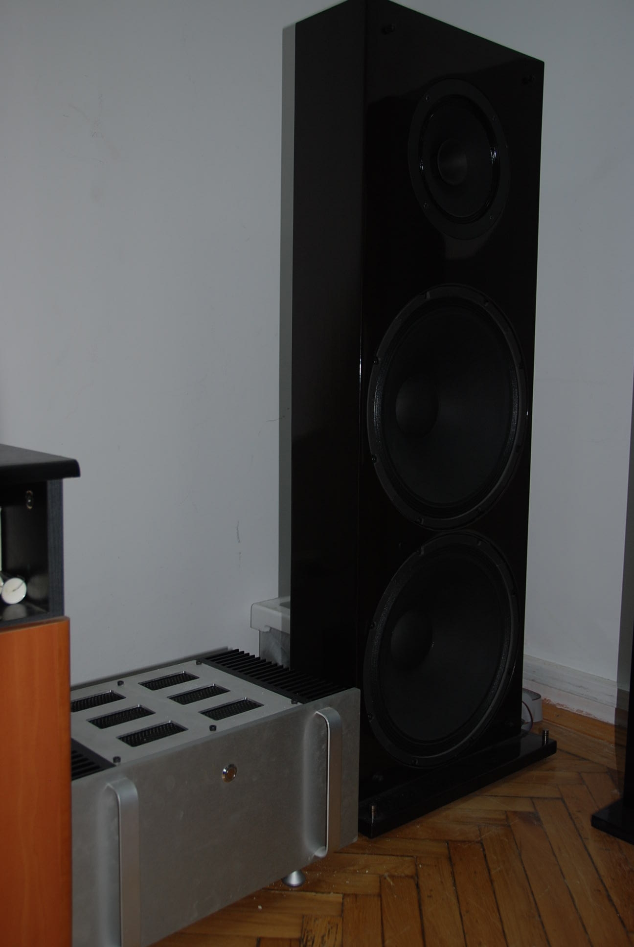

Hi Tinitus ,
I have a Beringer DCX2946.
I go on the variant:
Supravox 65 - directly to F5;
2xEminence Alpha 15 : DCX2946 - vertical biamping F5.
If not to like, to go on an Eminence Alpha 15 with Aleph5 mono block, which has 90 watts per 4 ohm.
Thank you very much and ...Merry Christmas!
