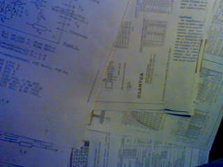

I have a danish manual on Hiraga, contains spec sheet on all devices etc
It was available as "kit" and 100% copy of original, supply and everything, excl case
I built it too
dates back from 1984

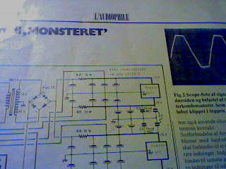

I have articles from danish "HighFidelity"
Careful study and explaining of 8watt "Monster"
History, background, schematics, the whole lot
Dates back from 1987

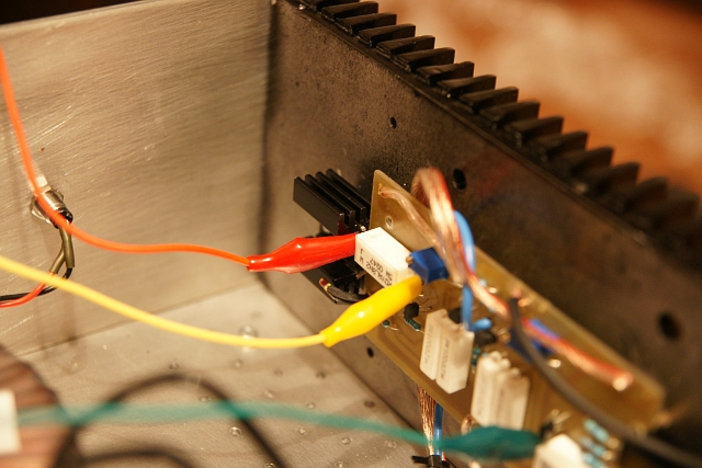

So the temperatures (Celsius) results with bias 1,17 to 1,2 A for my amp after 3 hours:
Big heatsink - 45 ;
small sink - 60;
trafo - 32;
bridge 42.
I think i should buy mica instead of silicon pads.
yes - and it sounds great.:cool:

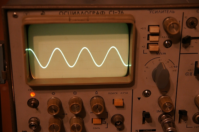

picture of 32000Hz sin wave, square i cant get from old generator - its looks like drunk square :D
