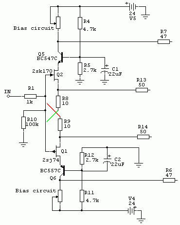

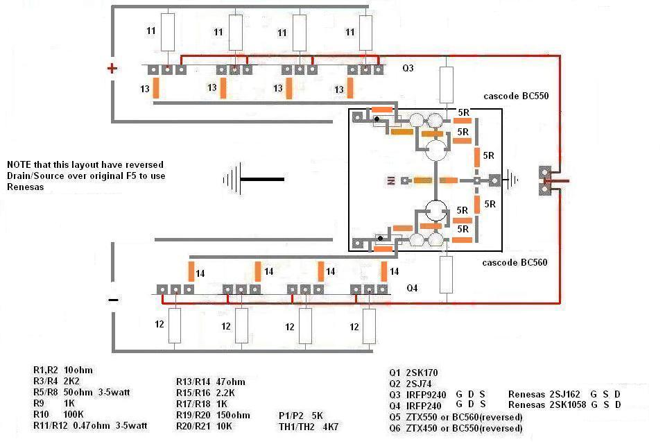

Now you are at it, regarding cascode connection
We have had two variations
One with base resistor/cap connected directly to Jfet
Other variation connected directly to ground
Nelson clearly stated that probably somewhere in between
Or that it would be best to try it out, what to choose
And what really makes the difference
Certainly not the present 10R ground resistor, at least I guess not
So, it must be the direct connection to Jfet that might be critical
Is it the 2K7 or maybe the cap
I have decided to replace the original 10R ground resistor with 3x 5R resistors
They are ofcourse individually adjustable
Maybe a trim pot might work too, maybe just in paralel with resistor to fine adjust
Just my thoughts about it
Please read #NOTE#, pinout is changed to use lateral Renesas

Hello Thanh
I'm interested about the 2SK246 & 2SJ103 if you use them as a cascode .
Patrick gave me a great advise but hard to find parts unfortunately ....At least I look on the Ebay and not one piece I sow.
Or if is so much secret and you want to keep for yourself it it is not a problem .I do not get upset NEVER on those people who willing to help with out criticise my plan .
Give it up ! And so on it make me to act like these especially if I'm tired .
Even you wrote before Andrew not very helpful sometimes even do he has the knowledge and great ideas.
Yes he tried to help me but the way he did it that made me act like you wrote .

Even do the amp would work with out any cascode , but if cascode will make easier to the JET to drive the power mosfet I would like to use it.
All do JUMA advise is great to !!! And I have some BC550C/BC560C at hand .
I order the parts , I want to use Takman metal film resistors , and in one order (shipping cost) I would like to order all what I need .
If you willing to share your secret please write to me

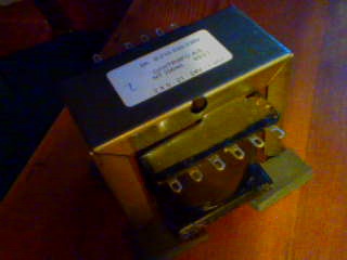

Im planning to try seperate supply to cascode/Jfet
Cascode/Jfet on 35V rails
Output stage on 30V rails
I have C-core trafos/1.5A and switch diodes
1.5A trafo should be sufficient, right
Im a bit concerned about grounding
And resistor values

http://www.borbelyaudio.com/adobe/ae699bor.pdf
Fig.17, Q3, Q4.
The devices he uses will NOT do. Idss too low, giving only 2V Vds on the K170/J74.
hardly - for an amp with same current consumption .
I'm usually using 1.5A xformers for my preamps :rofl:
or I didn't understood you correctly .......
just in case (just one of pretty often forgotten breadcrumbs) :
  • powersupply.pdf
Ex-Moderator R.I.P.
Joined 2005
Oh, small trafo fore input/driver only
Output stage will use trafo with 18-22V/18A, or so
If possible, the point should be better drive from cascoded/Jfet through raised voltage(35Vdc), and retain lower voltage(25-30Vdc) on output stage
