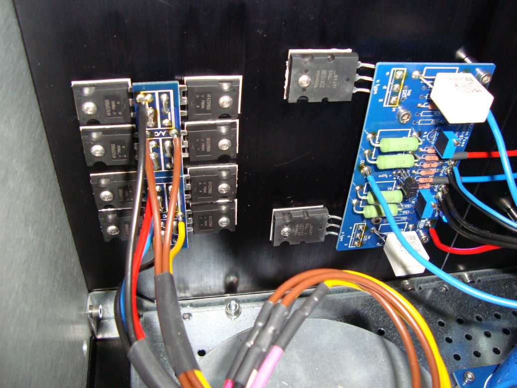

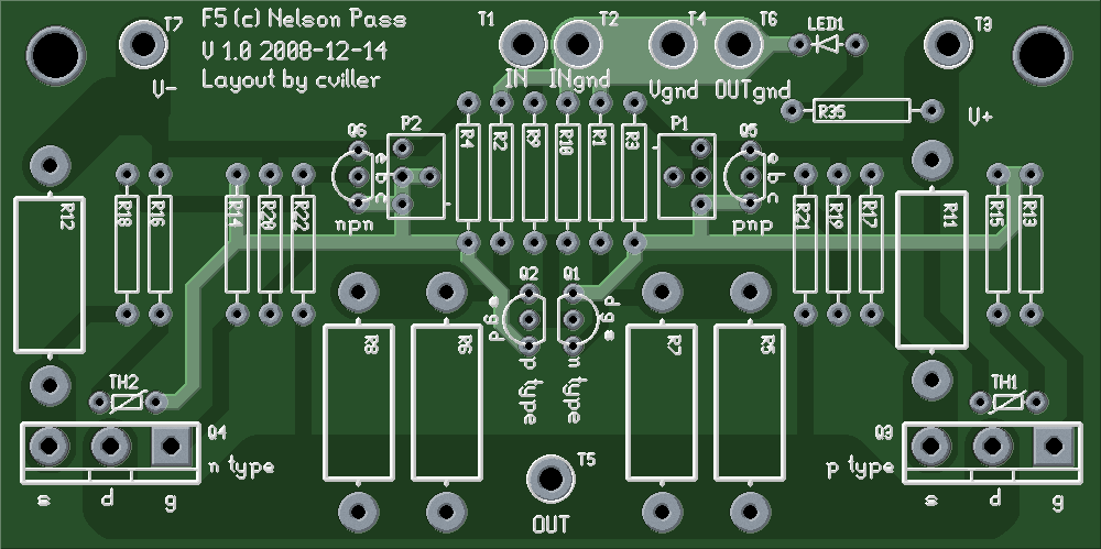

If you com pair the two picture you can found many great information .
They appear to be different, regarding the Q5/Q6 limiter and trim pot
I didnt know Cviller made more versions
Hello Tinitus
You right , but the rest of the layout is the same .
I said I found many great information because I was searching some information how and were to connect the ground !
The resistors on the Smyslow board for me is a great help .
Now I know more now about the F5X ground due to the pictures , so I can go on and make my PC board for the high power F5X . I have the cvillier F5 board (based on the blue board ) I post the right pictures now !
You can see the rest of the board is the same .

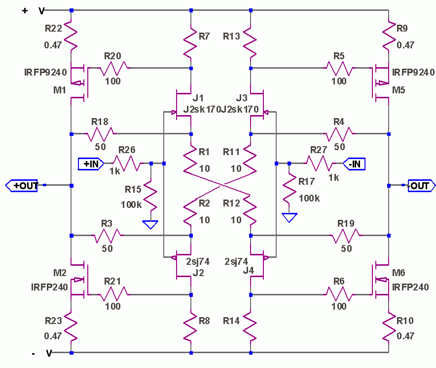

The 100k resistors are certainely necessary in order to state the Jfets gates dc null voltage.
The input cable ground connection is an other thing...
...The central node excepted (crossed connexion) this is twice the stock F5!
Should M1/M5, J1/J3, M2/M6, J2/J4 be matched?
Setting the biases wouldn't be a little tricky? Do you know how you will proceed?

I was speaking about matching the two sides of the X.
I am thinking about one way to set the bias:
Grounding the X node momentaneously gives the equivalent of 2 stock F5.It is then possible to set the biases separately following the usual process. (may be to a lower value for starting) then unground the node.
Just an idea.

I could be totally wrong but I think there should be another reference to ground around the feed back loop like there is on the Aleph JX.
For some reason I don't feel comfortable with this circuit design.

I just posted that schematic because the schematic originally posted there is no ground at all .

Yes you should go with this design.
I just want to make sure you get the best possible info and advice on this one.
One thing I dont like about it, is 4 trim pots to adjust bias and dc offset. This could be a nightmare trying to adjust.
If the Jfets are matched, I think you should be able to get away with two trim pots.
Anyway it would be nice to discuss this design a bit before you get into trouble with it.
Please read Smyslow comment on both amp .
He built at first the regular F5 and after couple month he completed his X verizon .
To him the X sound better than the regular F5, it is improvement .
Also Patrick use protection 4PC BJT and extra 12PC resistor each channel.
I would like to to build mine exactly after the Smyslow amp .
