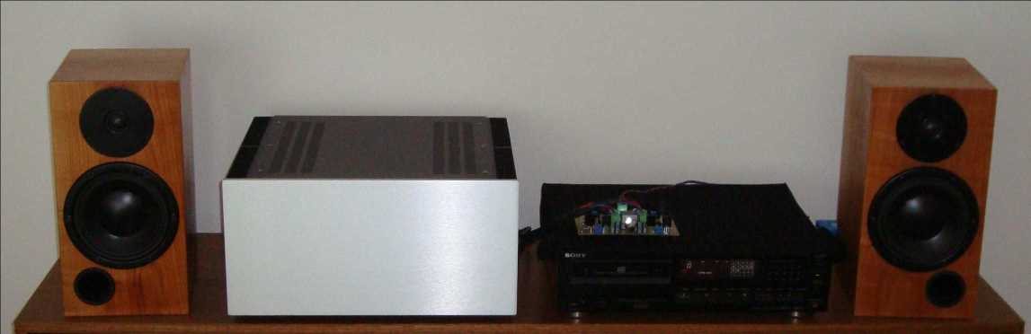

I've only compared the F5 with my old diy amp, which is now approximately 20 years old. It's design is based on the Crescendo amplifier published by the Elektor magazine. But the F5 is much, much better then my old amp.
BTW, here is a pic of my current setup. As CD source I use a Sony CDP 337 ESD and the speakers comes from Dynaudio. On top of the CDP you see a pcb with the single to balanced converter, which is my present diy toy
Uwe

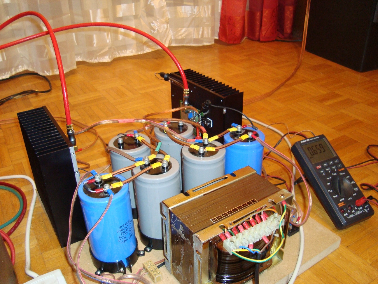

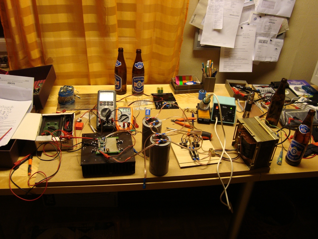

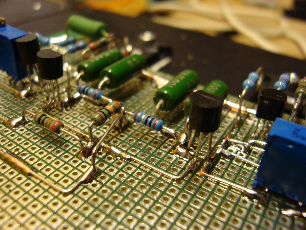

Hi all,
as Uwe suggested, there are some nice pics from our first F5 building session which we want to share with you... We built this monster in order to get first impressions of the sound and stability, so please ignore the "Frankenstein" look of this amp.

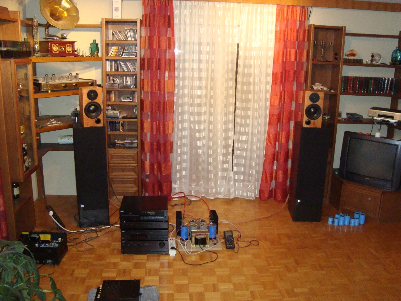

Funny sidenote: Ignoring the strange (some may say "technical") look, the sound is really great, so I decided to keep this monster in my livingroom until now... althrough the WAF-factor is quite low
My current setup is a combination of F5, fed by a D1-clone (TDA1541S1 to first stage of D1, followed by B1 used as output buffer), and the sound is really amazing!

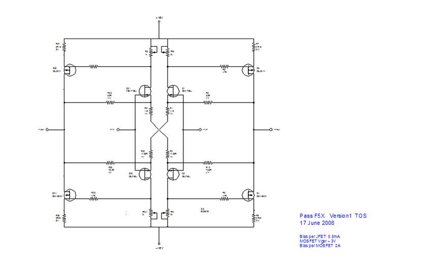

Thanks to all of you for your contributions to this project, thanks to EUVL for his Toshiba-based F5 schematic, and special thanks to the Master himself for sharing this wounderful design with us & keepin' the DIY spirit alive!
greets, Michael
