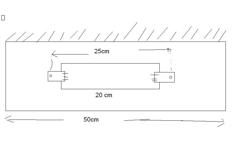

About transistor position
Hi.I have a look at the diyers pcbs and see that the distance between two transistors are short..I have 50cms long and 10 cms height 1,5kilograms cooler..have a look at the picture.Am i wrong?I remember that Nelson said far from eachother is better for good cooling.but most people does opposite of this.Why ?
Ahh. . .the only thing I can think of is cost. I hope when and if someone does a J2 board they'll move those expensive output devices a little farther apart.

I think it comes down to parasitics.
Longer track lengths = higher parasitics = more chance of creating instability.
I could be wrong though
That sounds more like SMD IC, or other unstable curcuits
To me, it seem like Nelson puts the Jfet well away from outputs, so I suppose theres no issue
I also believe to remember he said to keep input away from supply lines
And that the most common cause of instability is wrong interconnects
Obviously the input Jfets are somewhat sensitive
Maybe best keep noisy lines away from them
Yes I agree with that.
I thought he was referring to keeping the output devices away from each other, for better heat dissipation.
I didn't think he was referring to output and input devices away from each other.
Ex-Moderator R.I.P.
Joined 2005
Ahh, yes ofcourse, I responded to the mentioning of parasitics
Nelson does put outputs far from each other, but remember if looking at F5, theres only one pair
Thanh, ofcourse your right about it when we use multiple pairs, the individual outputs on each side should be kept fairly close together, but I suppose theres a sensible limit to that too

Without compensation, the bandwidth is typically around
1 MegaHertz, and that means well done grounding and
shielding on inputs and outputs, and not much tolerance
for capacitive loads at very high frequencies.
Internal layout with regards to transistor placement is not
critical.
