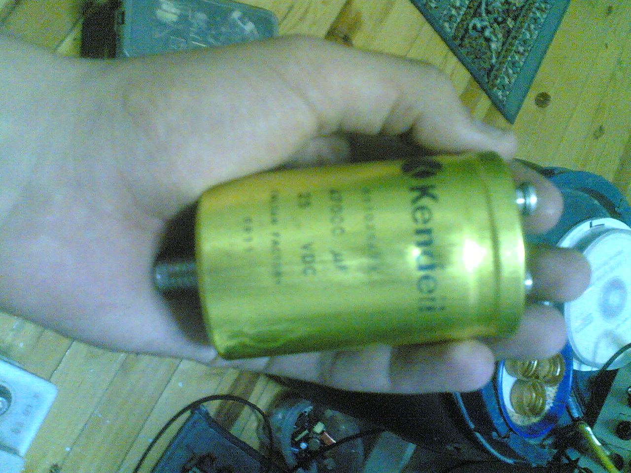

hi..i have 8 pieces of italy made 25volts 47000uf kendeil capacitors and 0-18 0-18 0-18 0-18 toroidal transformer.. what kind of power supply should i design?what is the most reliable power supply for using with F5 amp?dual monoblocks or other types? how many bridge diodes should i use ? i will take photos and send asap.. thanks

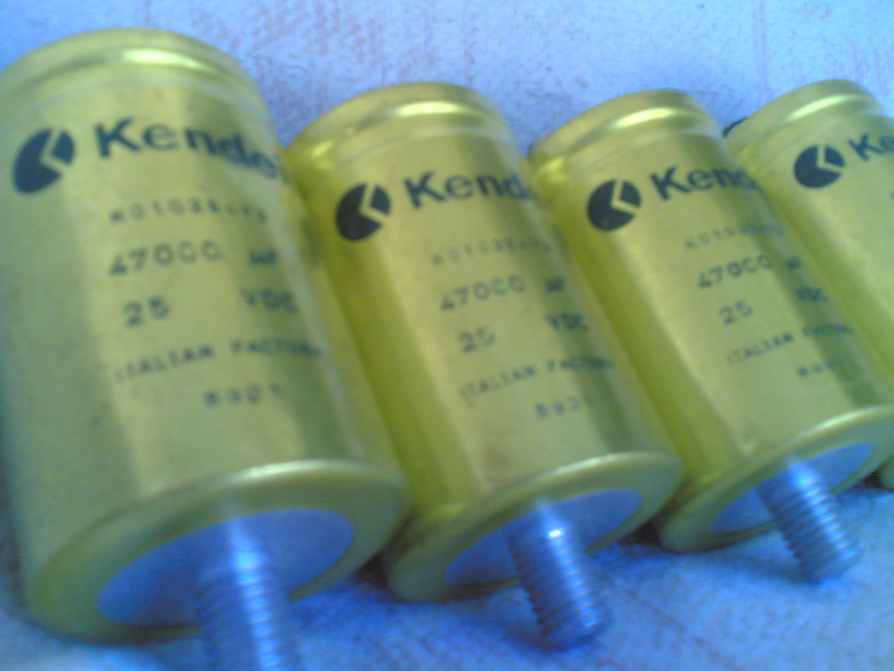

how to calculate the most reliable power supply?
hi Andrew..i dont know how to calculate the most reliable power supply for F5 amp..i have these materials
1-) 0-18 0-18 0-18 0-18 600VA toroidal transformer
2-)8x 25volts 47mf kendeil capacitors
3-)0.47 ohm 3watts dale resistors
would you say how to make the best supply and best noise reduction and how many resistors should i connect paralleled for it?thank you

+-45mF is not a lot for a ClassA amp that can drive 4ohms into ClassAB.1. Is there a reason why you need so much more capacitance for a CLC as compared with a CRC?
2. In your example: "180turns of 1.6mm diameter enameled copper on a 48mm air core former " -- how many Henries does that come out to?
I posted the air core inductor spreadsheet quite a while ago.
183Turns calculates to 2.0mH and has 0r34 resistance, but it's big. 14.3turns/layer, 12.9layers = 184Turns resulting in 89.2mm diameter and 22.9mm spool width, using 40m of wire.
2mH using 1.9mm wire gives 103mm diameter and uses more than a 1kg spool of wire.
