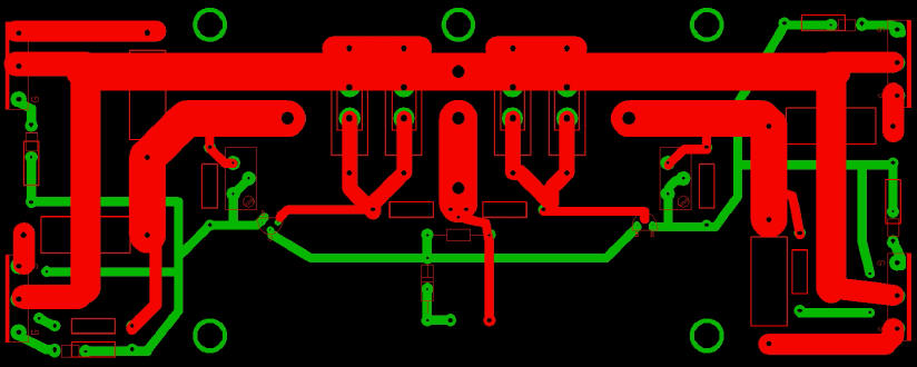

Parallel layout
Hello, I made some adjustments based on earlier comments to my layout for a F5 with parallel output mosfets. Can anyone take another look through for potential issues?
Also 2 questions,
1. Is it better to route the signal traces around the perimeter of the board v. crossing under the power and output trace?
2. Will the thermal compensation circuit still work with parallel devices, and if yes do I need a thermistor at each mosfet or just one per p/n channel?
Thanks everyone for entertaining a noobies questions and of course NP for everything you share.

Re: Parallel layout
Also 2 questions,
I usually put all my power and output tracks at one end of the PCB away from small signal tracks.
The one and only
Joined 2001
Re: Parallel layout
2. Will the thermal compensation circuit still work with parallel devices, and if yes do I need a thermistor at each mosfet?
The Oracle sees all, tells all.
1 It doesn't matter as much as you think it does.
2 Yes, and No.
:cool:
