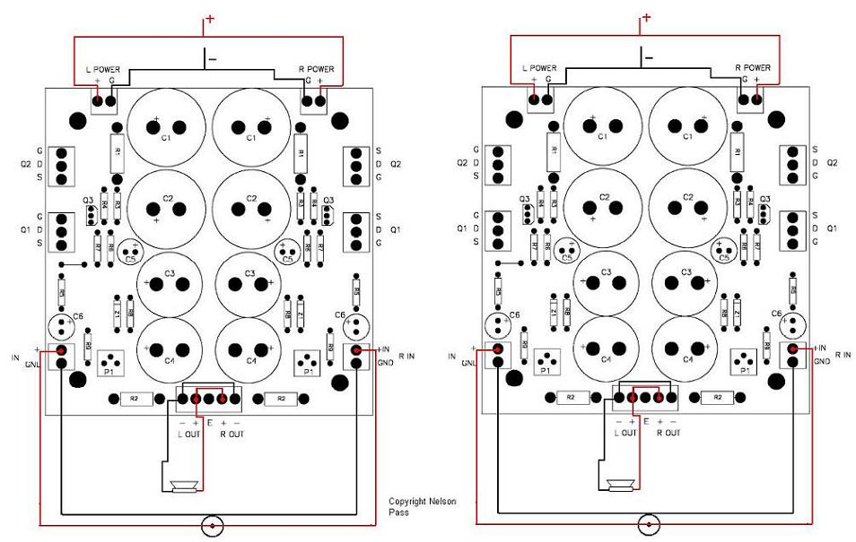

I've just put together my F5 using the Peter Daniels boards. I have a problem.
The set up is dual mono, and the rail voltages all are correct. However I can't seem to bias the channels. So I have my +/- 24V going into the boards. From the pass manual, I'm supposed to measure the voltage across R11 and at the same time adjust P1. I do this going back and forth between R11/P1 and R12/P2. So the pass manual states that the end point should be 0.59V across R11 and R12. In the subsequent paragraph, he says that its a good idea to start low, maybe 0.4mV across R11/R12.
Theres a big difference between 0.4mV and 0.59V?
Anyway, I don't seem to be able to set the bias at all. I measure across R11 or R12 and all I get is 0 to 2.4mV. no matter how I adjust P1/P2. If I do a check on voltages at the speaker output, I get about 40mV most of the time, but if I watch as I adjust P1/P2 very suddenly I get the rail voltage to the speaker outputs.
Don't see what I have wrong. Need to take some photos too.
Any suggestions gratefully received!
Fran
Fran

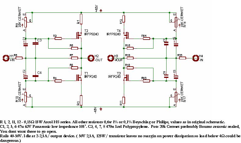

Bridging Power
Bridging two F5's across the same load (say nominally 8 ohms) as a single F5 both doubles the voltage swing and the current, all else being equal. P=IV, so 2 x 2 = 4. A bridged F5 pair should produce at least 100W, but it will come out of Class A operation at a percentage of it's output rating....probably ~ 50-75W. The big IF is the current limit of the amplifier, which in NP's circuit is nominally 10A. Driving an 8 ohm load, each side will conduct about 2.5A and together put about 30V across the load.....at which point they will go into AB mode.
The ultimate limit of AB mode is probably set by something else in this circuit, but when I get mine built I will have my buddy Zaw test it on his HP bench and I'll tell you when it clips.....knowing NP's bullet-proof design approach I'm betting about 120 watts into 8 ohms. Perfect match for a set of Vandersteen Quatros or 5A's, and the first watt will still be sweeeeeeett Class A "quantum triode."

I installed Q2 backwards. Never saw it despte checking.
So I turned them around but neither channel works. Could some kind soul let me know whats likely to be dead and what I need to replace?
Anyone any ideas?
If I just order more of Q1 and Q2... would Q5 and Q6 be affected by my mistake?
Fran
