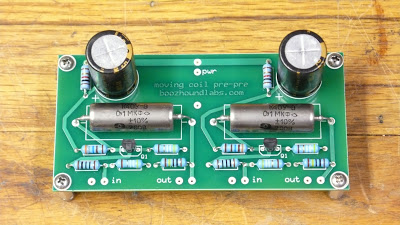

Boozhound Laboratories: JFET Moving Coil Pre-Preamp lit
I am thinking about putting these in front of my Boozehound phono stage to get more gain. I track down a schematic (it's actually a bit different but almost the same)...looks pretty close the the jfet BOZ. In fact, other than some resistor and cap value changes it is the Jfet BOZ.

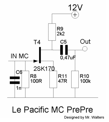

In your position, I would be tempted to buy Papa's Pearl Two boards with the JFETs and just build the front end (cap couple from the collector of Q3), this will also give you the option of building the full project later on if you wish.http://www.diyaudio.com/forums/pass-labs/156397-pearl-two-33.html#post2245791

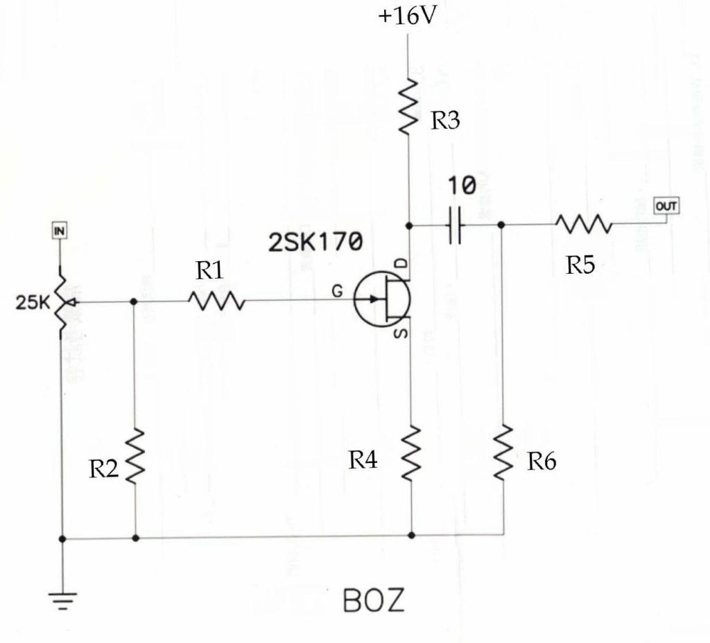

I cobbled together a jfet boz. Vinyl sounds awesome. F5 needs a preamp i think. Everything is better. My expeience is that the f5is a bit handicapped without a preamp likes input gain. Some may disagree but i cant see how a buffered passive pre is the right combo for an f5. Thanks for the help guys.
