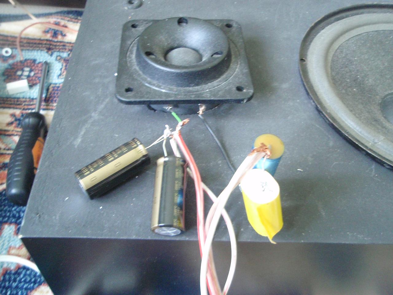

There is no need to diagram.Just connect silmic capacitors to tweeter in series and you will see that the sound becomes smoother.(IMHO) Thanks
Wouldn't that change the phasing? 90 degrees?
Scratches head trying to remember.......
Ron
No it does not.Firstly you have to learn to calculate filtering at speakers.There must be a capacitor in series tweeter everyway.(if you do not use active preamp at the input of the amplifier)
For example if you have 4.7uf capacitor and if you connect 2000uf capacitor in series it is the formula
1/C(equivalent)=1/4.7 + 1/2000 = 4.68uf nearly changes nothing at phase
