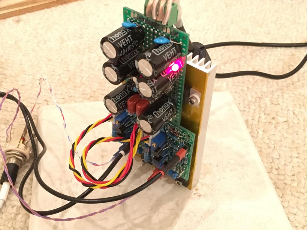

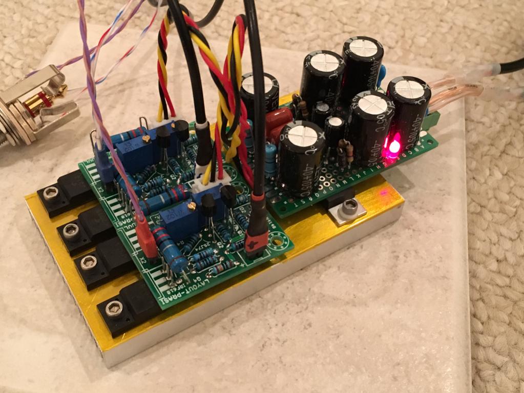

Super compact 2SK2013/2SJ313 F5 HA with modified Juma cap multiplier. Just needs external source of +/- 18v to 19v. Dual 19v laptop SMPS in series can work.
Very tight and nice build ! With less than 1 mm between boards so tight that one almost asks himself why no single board was used Just teasing, it is good that the cable and connector industry keeps work.
One point of concern: the caps look like suspect brand/types and some googling reveals that "ChongX" (who invents these names?) really are mediocre...When one rail fails I guess it is known what happens with DC coupled amps. Most good headphones cost more than 6 good caps cost. No DC protection means careful choice of parts is needed.
You seem to trust on the transistors keeping the boards in place but just a minimum of 2 short standoffs and connections have way less possible mechanical tension which translates in higher reliability. Why not cut the transistor lead wires ?

Very tight and nice build ! So tight that one almost ask himself why no single board was used Just teasing.
One point of concern: the caps look like suspect brand/types.

really super compact. how does it sound compared to your earlier regulated+CM versus just the CM?Super compact 2SK2013/2SJ313 F5 HA with modified Juma cap multiplier. Just needs external source of +/- 18v to 19v. Dual 19v laptop SMPS in series can work.

So far just tested sound to make sure it plays music at all with cheap earbuds. Using dual laptop SMPS bricks I am picking up a low level ground loop hum - so need to debug. It may just be a no go with these SMPS in which case a small toroidal with voltage regulators upstream again. Trying to keep it small though.
Regarding ChongX budget caps: I know they are cheap but I have had good luck with them so far and a dozen amps layer. Bag of 50 for $4
I think a single CM in the PSU is fine as I plan on using crossfeed filter so monoblocks with a million dB isolation isn't needed.

So, essentially we are building high quality class A NP inspired DC coupled stuff with cheap budget substandard parts hoping that we're lucky Kind of defies building high quality devices somehow....maybe a DC protection/muting circuit is not such a bad idea.
