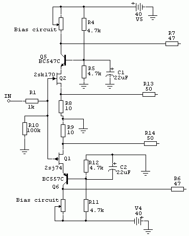

Ok guys, one more time:
To get a higher power on 8 Ohm speaker we need more voltage swing at output - in standard F5 it's 20V peak, for 50W rms we'll need about 28-29Vpeak. To achieve that we'll need +/-33V PS voltage and about 3.6A peak through speaker (if we want all of the 50W rms in class A the bias current should be 1.8A and that means two pairs of output mosfet with 900mA running through each pair). Personally, I'd use a 500VA toroid in PS and double amount of filter Elkos, but it can be negotiated. Bigger heatsinks are a must, too (Pd=66V *1.8A = 119W per channel - almost the double).
Simple, right?
Now comes the cascoding - why do we need it?
With higher PS voltage comes the greater dissipated power in input JFETs (plus, the 2sj74's datasheet says that it can't take Vgds higher than 25V, although Nelson tested them and says it's safe up to about 40V). So, the first objective of cascoding is to protect the JFETs from high/risky Pd/Vgds. The additional benefit is that cascoding enables JFETs to work in constant Vds (or near-constant Vds) regime which decreases influence of parasitic capacitancies and lowers the distortion, extends freq. range, improves the sound and kills werewolfs.
Are we in clear now?
Simple, right?

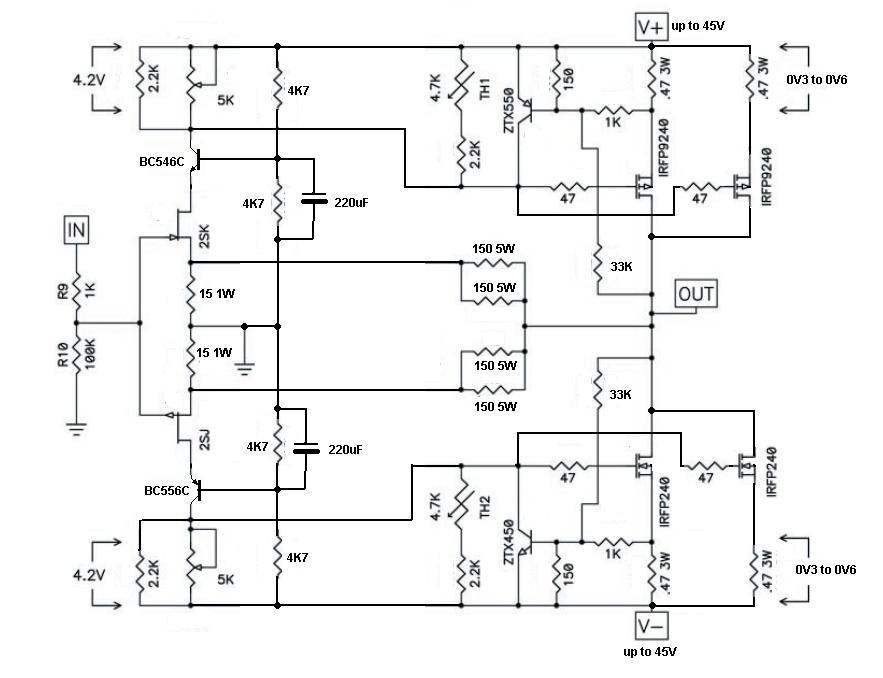

I do know that Juma and thanh has posted cascode suggestions
One of the later cascode suggestion was posted by Nelson himself
Im not 100% sure, but I think its this one
but its similar to another suggestion, I think came from zenmod
do not use suggested supply voltage
I wouldnt use higher thna 22Vac trafo, giving about 30Vdc
First drawing is mine - made with CircuitMaker. The scond one is ZenMode's.
