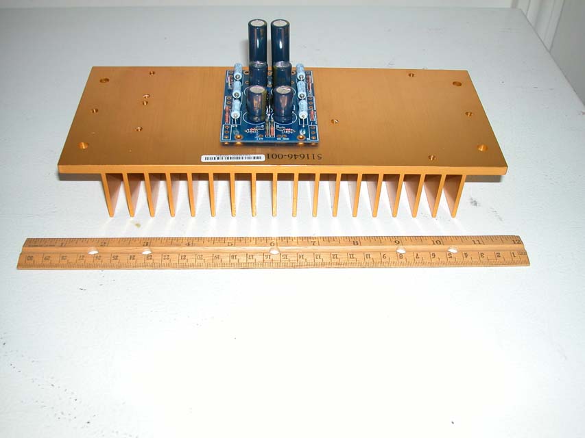

Heat sinks and transformer for F4
I was wanting to use these heat sinks for my F4 amps. I know they are a little small and I was wandering if it would be better to lower Bias or only use 4 Mos fets instead of 6? I also have a choice of transformers 200VA at 20 volts or 300VA at 18v. If I go with these heat sinks and the 200VA transformer I can make it into I fairly compact case

This is a matter of choice. 18V seccondaries dissipates less then the 20V (11%). What could be more important is that the maximum voltage of one the jfets is 25V. Chosing the supply voltage higher than 25V, in my view, is better not done.
18V secondaries will give 24 - 25V supply.
20V will give 28 - 29V.
If you go for 4 pets, you can have a higher bias, sure. Stick to 6 fets and you have a higher thermal reserve. I'm not sure what I would prefer.
Higher bias defenately will sound better.

heat sink WAY to small.

Ok, here's a data point: back when I was planning my F4 I told Nelson that I was thinking of making balanced F4 channels with just two devices per channel. (ie a total of four for balanced amp channel) He told me to make the amps with 6 per channel (ie 12 per balanced amp channel as "the specs were better"
So I did! and I'm glad I did!
and now we are back to the same question as I STILL wouldn't mind a two device per channel/4 per balanced amp configuration as is being discussed here for my mids/highs if there wasn't a performance hit. It occurs to me that maybe another MOSFET might work better with fewer in parallel. Like maybe 140's or 250's -both of which I have (but I would have to buy the other opposite channel versions)

DF is certainly better with more devices in output ;
but - that 's a goal if you use it in widerange config ; if you use it just for your dreky Fostex you are good with just one pair of mosfets per channel ( two for balanced) ; having more DF is just irrelevant
it''s always matter of compromise .......... but main factor is heatsink ; if you have it ....... it's pretty irrelevant how many outputs you'll use , from costs reasons ........ because you already spent bigger part of overall cost .
