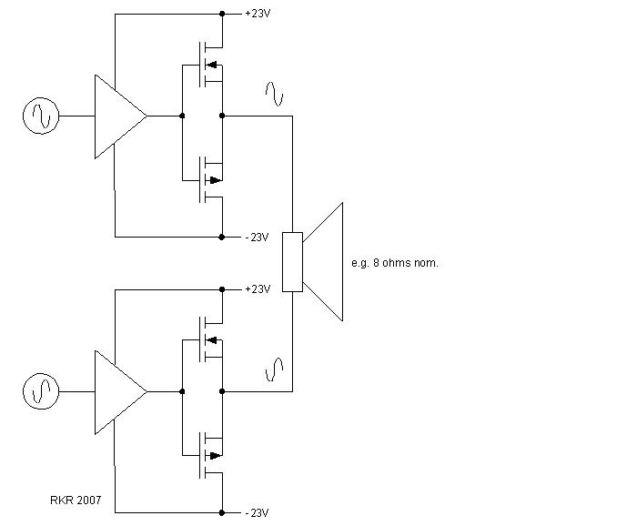

The F4 has ~+-23v as we know. I was going to use irfp140/9140 outputs. simple 'nuff, but here's the quandary - and my ignorance is shining here;) I've decided to bridge them. Does this mean that the outputs will see twice the +-23v across them in the bridged configuration?
The 140 is a 100v fet, so you can see my concern...

I'm not sure about this - will the 100v irfp140 / 9140 see the full swing of both amps in bridged config. I'm thinking that it will still see only +-23v but I'm not 100% sure :smash:

In bridged config. the output devices will see exactly same voltage (+/-23V)
The concept is shown in the attached picture.
When the upper amp swings towards +23 V, the lower swings towards the -23 V rail, putting all that voltage (46 V) over the loudspeaker.
NB! Dynamic loudspeakers and magnetic pick-ups (moving coils for example) are born symmetrical.
