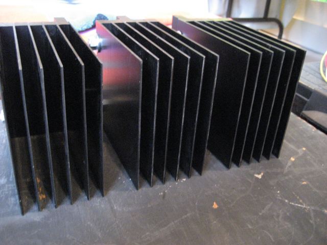

would this be an appropriate place to ask for a recommendation for heat sinks for the F4? I am looking to build the four channel, balanced configuration using the schematic in the service manual. My least favorite part is casing projects up, so I promised myself I would start here this time to ensure things actually get completed :cool:
Thanks in advance!

As far as heatsinks, as we just discussed , look at any of the First Watt amps and since you are doing the balanced configuration, double the size. NO doubt even bigger is good..

I haven't had much luck with the search engine, I've read all the posts with "heat sink" in the title and having problems finding older First Watt amp threads that talk about heat sink sizing :dead:
Any idea on what size I should be looking for? I was considering two 400mmx160mmx40mm which measure Rt°C/W = 0,23. I'd prefer to go with this one, as it will match my other DIY stuff and includes a full case. Other than that, I guess there is always the surplus sales large plates that measure 11-5/8" x 26" x 1-1/8" high or 11-9/16" x 18" x 1-1/8" high. :D

nope ;
you'll get (320W/2 x 0,23 x 1,1) + 25=65,48 deg C ....in best case
what's C/W ratio for these?

Or, build one like mine. :)

In my view it would be more practical to build two normal stereo versions of the F4 with the added bonus of being able to run them balanced so they act as two monoblocks. Nice and flexible.
You even gets the added bonus of being able to move the amps:)
The heatsinks you mention should be good for monoblocks, if you have 4 of them. Do you have a picture of them?
Steen :)

I am starting to agree about the separate chassis. At this point, I'm just looking for the largest, single heatsink I can find. I've come up with these:
http://www.surplussales.com/Heatsinks/HeatSink1.html
and the MF35-151.5 from Conrad. I've e-mailed surplussales about the thermal resistance of the two largest heat sinks on the above page. It "seems" that the (HSK) 6-H001-A is will have a lower thermal resistance than the Conrad MF35-151.5...
Then there's the heatsinks at www.apexjr.com that Zen Mod refered to above... the price is definitely right, but I wish they were black ... choices, choices...
Also, maybe with so many people buying F4 PCBs there can be a group by of the R-Theta heatsinks again? :devilr:
