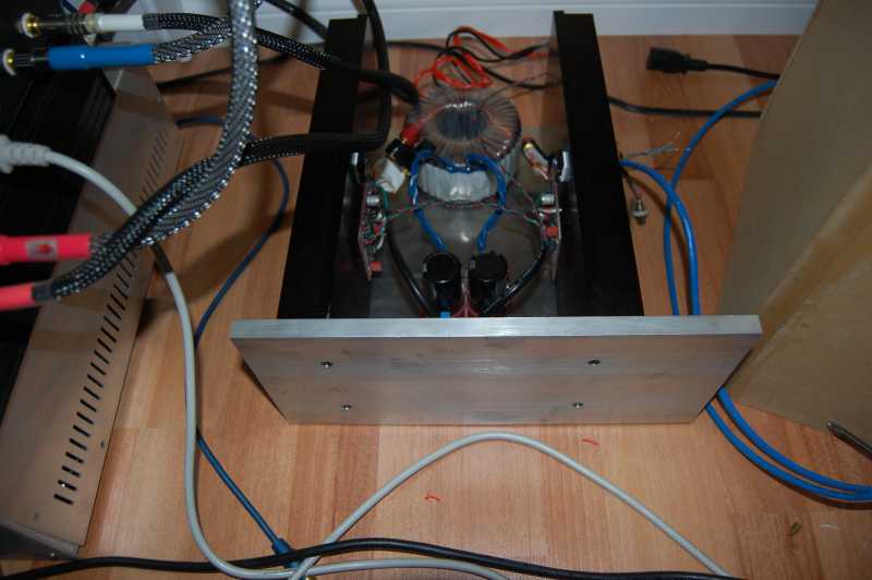

Plitrons Price for a 18-0-18 @ 400va is 105$ with out shipping
EBAY $55 for the same thing from Antek, trust me i have priced parts around.
Cases ill build my self, parts like fuse holders and fuses and feet and speaker terminals rca connectors etc etc i have LOTS of those things. I do know what you mean, trust me i have sat down and looked at places where i can get them cheaper but still good quality.

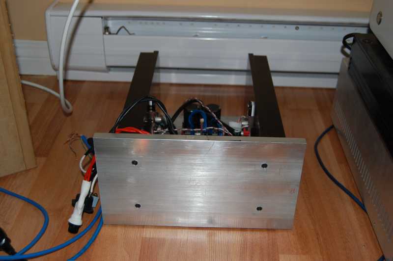

Yes, i diy all my stuff, some stuff i used to buy like chassis, NOW im getting the hang of using a Drill and tap and proper metal working tools that i didn't have.
I just spent 4 hours drilling and tapping this, then the drill bit jammed some how and wrecked one of my face plates good thing i got all 6 faceplates for free, in this picture one with this amp, i have to get the face plate cut on one side as this is 13" and i only need 11" for the face plate.
Now to do the other amp off i go

Nelson Pass said:Pass Sez:
Always have your faceplate at least as thick as your interconnects.
Well i was reading your manual and that is what it said so i had to go with what you say
Thanks nelson

P.S.: Patrick, you need thicker interconnects...
