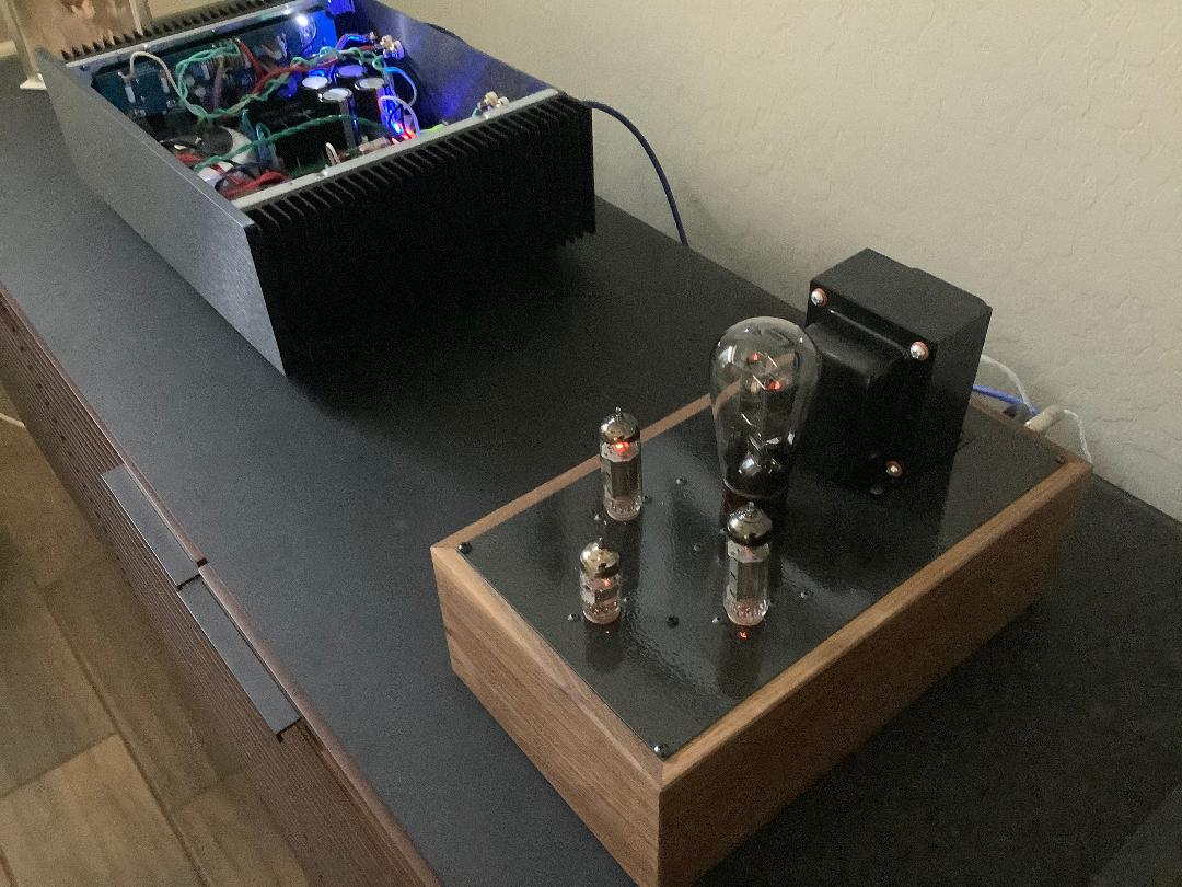

Incidentally, I just measured the M2 and it has the same noise as I measured in the F4. That was a relief. That means it is my measuring setup or environment that is injecting the noise. It's all in the open and there was at least one wall wart around, so, that could be it. Both the M2 and the F4 are dead quiet of course on the 110 db/W horns.
Been enjoying the F4 and starting to see it's character. It is quite lovely.
Just tried this for the first time and it is absolutely amazing sounding: no sonic cues were harmed in this experiment :D The SEP OTs (4 ohm secondaries) were shunted with 4R7 3W so that the right load-line would be seen by the tube amp. The F4, by way of adding DF and current, adds AUTHORITY!
The SE tube amp is very simple, and very quite, and so is the F4. So I run all of this without a line stage with either 2V or 3.5V from one of my two tube dacs.

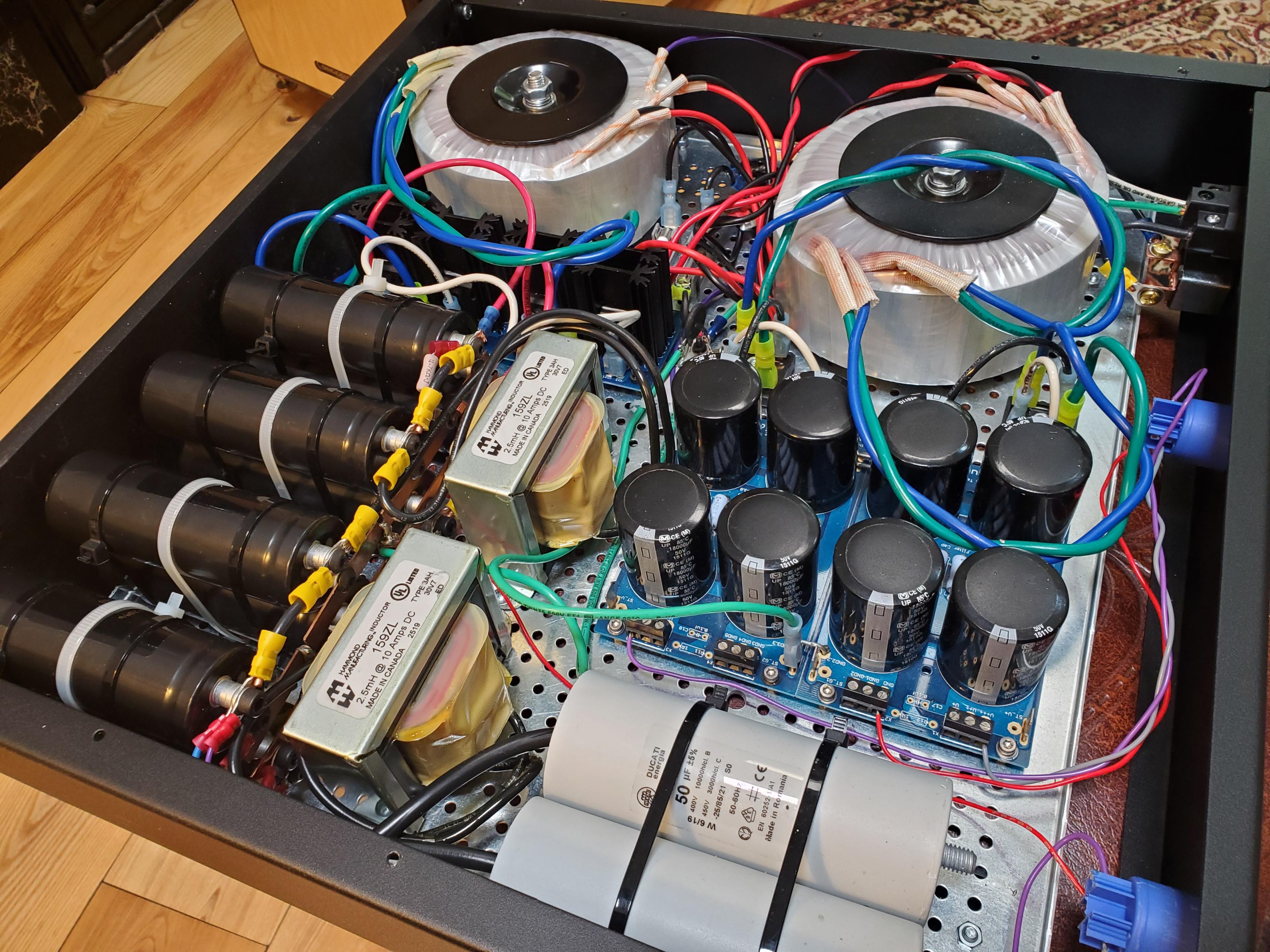

Hi folks. So I was reading about some $20k+ amps and read that each rail had it's own power supply transformer. This cued me to realize that I had a totally unused transformer in my power supply and could easily try this out for my f4 monoblocks (image below). Both transformers are identical, 400v anteks with dual 18v secondaries.
My question is, if I do this, what should I do with the extra secondaries. I read recommendations to just heat shrink each wire and then tie up the pair. Other people recommended connecting them in parallel to a single rectifier.
Any opinions from this group?
Thanks as always.

Great, thanks.
I read that there could be some problems if the windings weren't matched even if nominally rated as identical. Was thinking that really wouldn't be a problem here, but thought I'd go ahead and check. In many cases, I think the concern came from using identically rated secondaries across different transformers, thereby increasing the chances of voltage differences.
