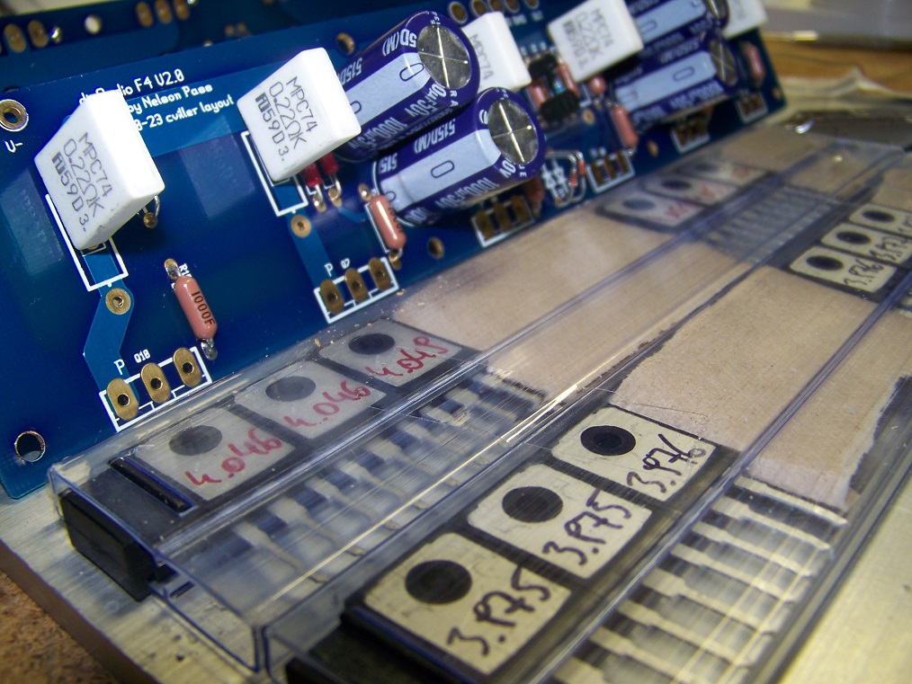

I've just completed placing the caps and source resistors.
The schematic seems to show two 0R47 resistors & 2 220uF caps!
So, I've soldered 0R22 Futaba metal plate resistors and 1,000uF caps.
Will I have trouble? More importantly, will this negatively affect
the sonics of this amp? :confused:
I just noticed this circuit, which shows paralleled 220uF caps and paralleled 0.47 source resistors.
http://www.diyaudio.com/forums/image...-schematic.pdf
F-4 clone boards (2 PCBs, makes 2 channels; Rev 2.0) - Power Amplifiers - Circuit Boards
Has it been decided 0.23 Ohms and 440uF is best?
No comments are made about it and there is no room on the board to parallel these parts.
Anyone know what the history is about this schematic?

schematic made with purpose of allowing two different pinout/cases/form factors on pcb, for those caps and resistors
then it's published without cleaning
use 220u and 0R47 , as per Papa's
though , if you squeeze 470uF there , who cares
OK then, what's the worst that can happen, if using 0R22 resistors on the source outputs? Lower output impedance? What is the purpose of these resistors, current balancing of mosfets?
1) Make it less critical to match components (load/current sharing)
2) Help linearise the device
3) Reduce thermal runaway
If you already have the amp ready to turn on. You may as well turn it on an keep an eye on the bias across each pair. I am also curious to see how low you can go with the source resistors with irfp240/9240

the size of the source resistor will be governed by the closeness of the current match . Having said that I would go with .22 ohm and not spend more time on a small thing . of your 3 statement 1. The reason for the resistor. 2. Not that much . 3. Mosfet are not BYTs thermal runaway is not there .:eek:

Thanks Zen Mod, Triodethom & 2 picoDumbs for your responses.
I will leave the 0R22s in, the mosfets were matched by diyaudio member h_a.

The point about thermally running away. IRFP240 are not lateral mosfets. They have a positive temperature coefficient. If you're heatsinks are rated for 100Watts to keep the mosfets in the SOA (say bias of 2A total on F4) and if the mosfets go from a total bias of 2Amps (0.67A each) to 4Amps then good buy mosfets this scenario can easily happen with irfp240 devices. You do need to be patient and careful when setting the bias with these devices.

Honestly, this is the first time I'm trying them. I bought a dozen each 0R47s and 0R22s when there was a group buy on DIYAudio I guess 3,4,5 years ago, from Forbis I think. They were super matched and marked.
Actually bought the mosfets from h_a two years ago. So, yeah I'm really slow getting things started and I just discovered I don't have the RCAs and banana jacks I thought I had stashed away. :eek: Amp will not be running this week. :(
