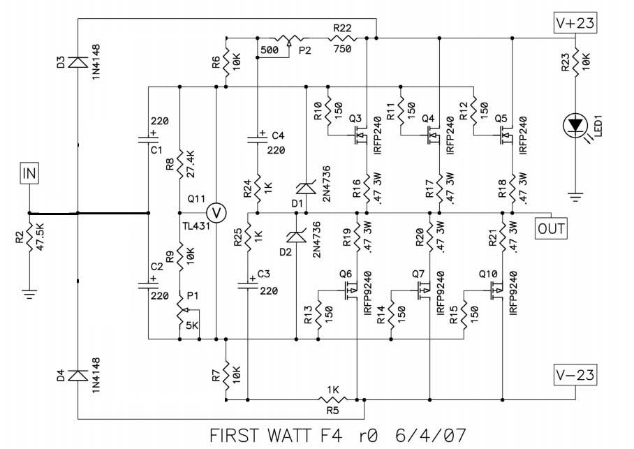

I´m building a crippled F4 with BA3 as frontend, and have some questions:
1: Can the output capacitor on BA3 be removed, as it seems like C1-C2 on the F4 effectively blocks DC?
2: Are there any reason to retain C3-C4 and R24-R25 when jfets are removed?
Seeing that similar questions are brought up earlier in this thread, but no one came with a concrete answer.
Regards

I thought that an earlier post had R24, R25 connected to ground rather than the Out for the crippled F4.
this one is later/latest F4 iteration ; difference to prior one (R0) is that and clamping diodes
though , both relevant only if you go berserk with input voltage

I built my crippled F4 per post 3354 and 3355 of this thread. I do not use any output cap on BA3B boards nor do I have C3,C4, R24,R25,D3,D4 installed but I defer to ZM if there is now a later reiteration .
Papa's Koan is with early production prototype pcbs equipped ;
I made some changes ( trying to keep it neat ) to pcbs , to make it that last iteration ; I'm sure that I implemented clamping diodes but , beat me , I can't remember did I moved those caps in new position
maybe time to look at those old pics , too lazy to dismantle amp itself
being pretty sane with input level , there is not issue at all , anyway
edit - just checked on pics - I did entire redo to latest R
