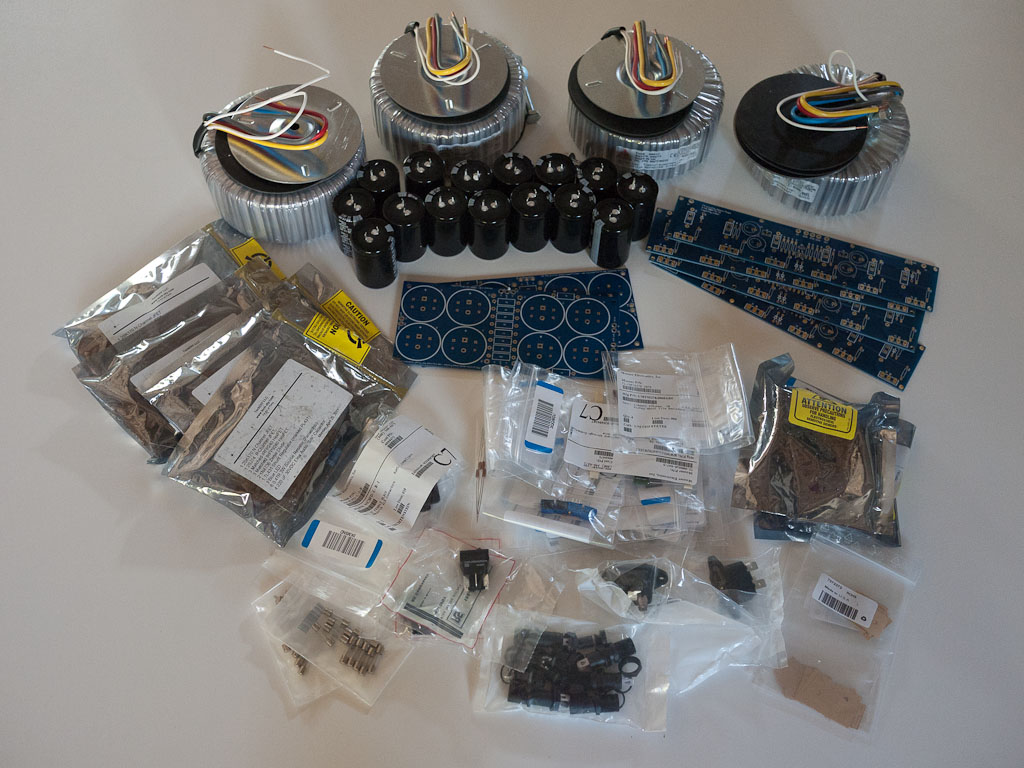

F4 - Components
Most of my components have now arrived.
Reading through 3000+ posts in the F4 thread, this is my summary.
Circuit: There is some early confusion on the exact circuit for the F4. The definitive version is labeled "First Watt F4 f0 6/4/07"
BOM: Again there are various versions of the BOM. The definative seems to be by Peter Daniels in post #354.
Circuit Boards: There is one early version by Peter Daniels in a square format. I have used a later version by cviller which arranges the output JFETS in a line. F4 PCB v1.0. I have used these as they are a better fit with my heat-sinks and chassis.
Semiconductors: There are many posts about the use of alternative semiconductors. I have stayed with the standard set available with matched output JFETS from Tech DIY Company Store. I have bought an additional 4 off of the IFRP240 and IRFP9240 output devices to see if I can do any better at matching.
Resistors: All the small signal resistors are 0.5W metal film. I have seen no posts that report on any improvement with exotic resitors, so I have mostly used Vishay CMF55 types from Mouser. Some values are only available in the Mil Spec designation RN55, but as far as I can see, they are the same resistors.
Capacitors: Here there is more debate with some suggestions of Nichicon caps for the 220uf 35V C1-C4 - also with bypass film caps (post # 2020, #2022). In the end NPass comes down definitively on the side of Elna Silmic (post #2047). These are included in the TechDIY kit.
Heatsinks: A topic for many posts. In post #1191 there is a calculation of the thermal requirment in C/Watt. Anything as good or better will do.
Thermal Mounting: There are a number of different solutions for mounting the output devices on the heat-sinks. (Posts #1283, #1641, #1728). NPass favors good old fashoned mica washers with "goop"- thermal paste (Post #1731). Also see post # 2320. If the budget allows, see posts #2737 and #2740 which talk about using copper strips to thermally connect devices over a long heat-sink
Transformers: The FirstWatt F4 uses a 300VA transformer with two 0-18V outputs to generate the +/-23 volt power rails for the stereo pair of F4 amplifiers. Best suppliers are Piltron (USA) and Amlimo (Europe). I have gone completely OTT and bought 2 off 500VA transformers for each mono-block chassis. Each chassis will support 2 x F4 amplifiers in either balanced or parallel mono.
Power Supply: A simple CRC PSU seems the most common option and is used in the FirstWatt F4. Cviller has produced a board for a CRC (see above). I am using 2 boards per chassis, one for each amplifier. Standard caps seem to be 2200uF 35V Panasonic. In post# 2868. NPass suggests that using twice the number of 1000uF, 35V Elna Silmic caps should give a PSU to die for. Being a sucker, I have bought a boatload form DigiKey. There are a number of posts discussing the use of bypass film caps over the main electrolytic's (#2043. #2613, #2615). There is even a whole thread on the subject. It seems that the net-net is to proceed with caution as bypass caps (no matter how exotic) can give rise to high frequency resonances and other problems.
Any comments and corrections on my understanding of "best practice" would be most welcome, especially as I have not started building yet.

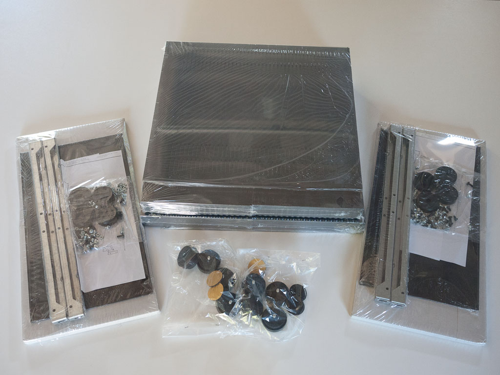

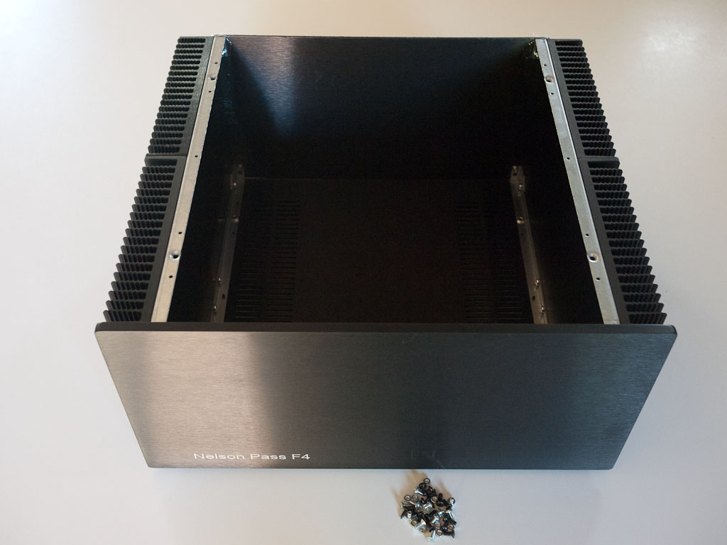

F4 - Cases and Heatsinks
The courier arrived today with two 5U 400mm cases from HiFi200. Great Italian craftsmanship. They are listed as "Pesante Dissipante" which literally translated means "Heavy Dissipater". Well they certainly are heavy - the courier left them on the front step rather than risk a hernia carrying them into the house.
As I suspected, each side heat-sink is in two parts. So now it's off to find some copper strip to thermally connect the six output JFETS.
(I am still worried about the small pile of screws leftover after assembly - never a good sign.)
PJG
