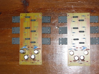

Populated Veteran's boards, but still waiting for the TL431 and the K170/J74 pair.
