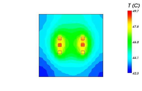

I've been playing with the R-Theta simulation tools trying to determine what the best orientation is for Peter Daniel's F4 boards using the R-Theta 9012 profile in 12" lengths.
I simulated three orientations. The first is with the MOSFET labels vertical, and the second is with the MOSFET labels horizontal and with the N channel devices on top, and the third orientation was horizontal with the P channel devices on top.
The reason for the last two simulations is that the FQA12P20 and FQA19N20C devices have slightly different junction-to-case thermal resistances. For obvious reasons, the first arrangement didn't need to undergo this flip-flopping of devices.
So, what I found via the probably very imprecise tool is the following:

Simulation #1 (vertical orientation)
N1,14.8 W,48.7,48.9,48.9,75.2
N2,14.8 W,49.5,49.6,49.6,75.8
N3,14.8 W,49.0,49.2,49.2,75.5
P1,14.8 W,48.7,48.9,48.9,77.2
P2,14.8 W,49.5,49.6,49.6,77.9
P3,14.8 W,49.0,49.2,49.2,77.6

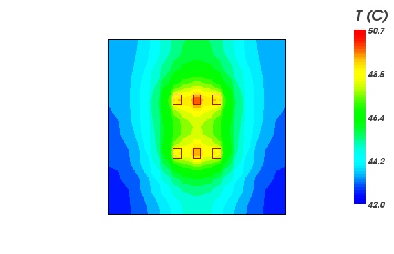

Simulation #2 (horizontal orientation, N-channel "on top")
P1,14.8 W,49.1,49.4,49.4,77.7
P2,14.8 W,50.2,50.3,50.3,78.7
P3,14.8 W,49.1,49.4,49.4,77.7
N1,14.8 W,49.5,49.7,49.7,76.0
N2,14.8 W,49.5,49.7,49.7,76.0
N3,14.8 W,50.6,50.7,50.7,76.9
Simulation #3 (horizontal orientation, P-channel "on top")
N1,14.8 W,49.1,49.4,49.4,77.7
N2,14.8 W,50.2,50.3,50.3,78.7
N3,14.8 W,49.1,49.4,49.4,75.6
P1,14.8 W,49.5,49.7,49.7,76.0
P2,14.8 W,50.6,50.7,50.7,77.0
P3,14.8 W,49.5,49.7,49.7,76.0
jimbo51 said:
Wouldn't 2 or 3 be preferable - lower peak temperature and more uniform spread across the fets?

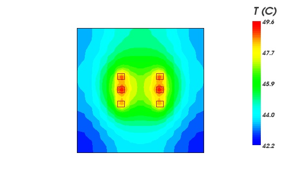

I don't know. The junction temperate is quite a bit higher. I did some more tests, this time using the first simulation and moving the FETs out and in. Surprisingly, the middle position was the best. I figured getting them furthest apart would be better. I think it has something to do with the heat sink boundary. I'll attach pictures:

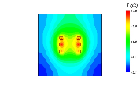

it's easiest if you download all the images in different tabs and switch to compare.. again, probably pseudo-science... I'm sure others have opinions that may be more useful. These last 3 images show about as far as you can stretch the boards with still using the legs of the device. I can post more data if it's helpful...
luvdunhill said:
wait, the last 2 have higher temperatures, but more uniform.. right?

Interesting simulations! :hot:
I doubt you'll get really good heat distribution with this placement of fets. Have you tried simulating what happens if you put all the fets on a row like some of the other pcb designs?

Using the same temperature scale on the simulations would also help making comparison easier. :D
luvdunhill said:
so, it looks like orientation #1 is best. Any idea if the last few hours were a complete waste of time or not? :)
Sure not waste of time, I have spent a fair amount of time on this.
The conclusion you most likely will end up with, is a copper heat spreader, aka a sheet of 10mm copper.
This will offer you close to perfect thermal stability.
The drawback, is that the warm up time is extended by the thermal mass, so it's a matter of preferences.

Heatsink and junction temperatures
Thank you for doing all this work. My take on what you have shown is somewhat different -- they are all essentially the same with only minor differences. Junction temp varying by 3 degrees, center FETs, whether P or N channel, running somewhat warmer than their neighbors. Seriously, I wouldn't worry about it.
It would be interesting however to compare the temperatures for the devices and across the heatsink if the devices were attached in a single row across the length of the heatsink, more or less equidistant from each other and the edges of the heatsink. . .
Thanks for your efforts. It is very interesting.
