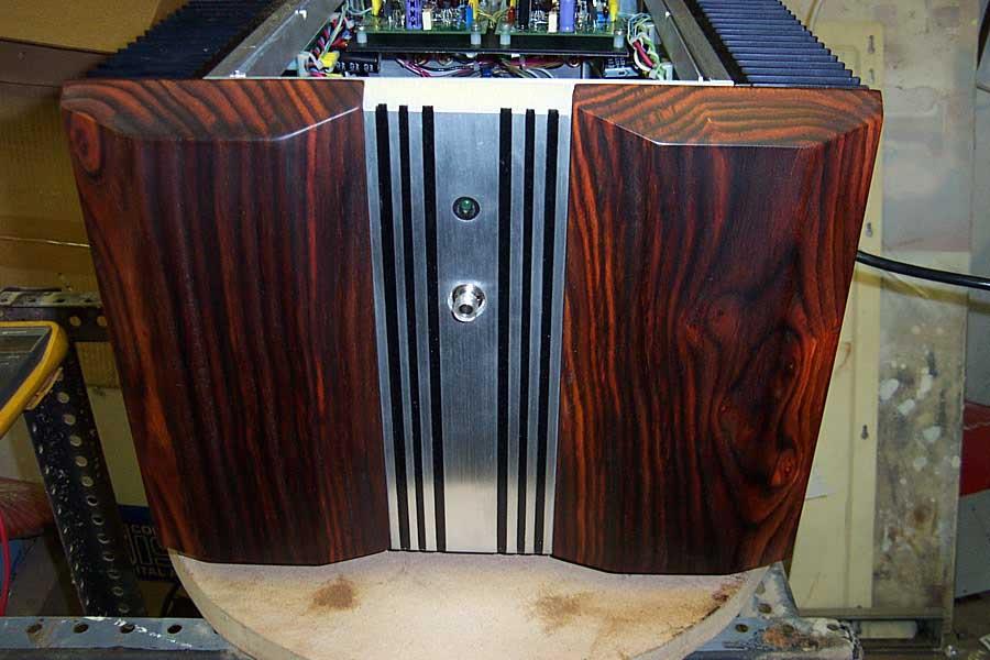

carpenter said:sculpted to fit a chassis in an exquisite manner.
José needs some matching furniture imo.
jacco vermeulen said:
I take it that the drawer is pushed open from the rear?
mpmarino said:I bet Humberto's amp sounds better, and they look better too -than my krappy Krell (certainly in this forum -at least ). I bet I can get better welding penetration with mine though.
I like your speakers, Woody.
I thought that looked like a lot of chassis--yes, suitable for a welder. It probably sounds much better when played through speakers rather than a welding rod...
Thanks for the compliment on my speakers.

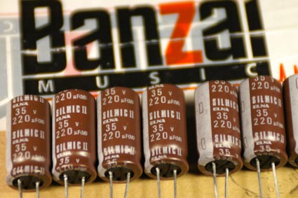

Re: Extra rail caps for F4
let me share experiences with C1/C1 caps. Two weeks ago I replaced Nichicon bipolars with Elna Silmic-II. As for my old ears - overal sound and ambient results are great – better base at the very beginning, more details, more air, more pleasure. Few days of caps burning/mature and I start to listen music which for me was difficult to reproduce. It is much better now, however higher frequencies of shrill sounds contain some unpleasant grain or sand, even if I am listening being at another room. Finally I realized method suggested by Jameshillj adding resistor 0.22 oHm in series with 47 nF as a bypass for 220 uF (C1/C2). Result is fantastic! In most cases grain and sand disappeared. Sound of big band trumpets is clear now, crash and ride cymbals too! I love it! Of course, not everything is perfect at my system but improvement is great. Maybe not all of my CDs are perfectly recorded or arranged.
Many thanks: Nelson for Elna Silmic-II suggestion and Jameshillj for bypass advices.
jameshillj said:Hi Andrzej,
Try adding a small resistor [0.1 - 0.3 ohm] in series with the 22 and 47nF caps - I generally use [100nF + 0.15 - 0.2R] as bipass for 220 - 470uF electros. Big surprise!!
Great that this is working for you Andrzej -
It's one of those try and see things, and it sometimes produces some top end ringing that some ccts just hate.
For more info, there is a series of articles about "Choosing and Using Bipass Capacitors" at the "TechOnline" site that's very useful.

José Humberto said:
Carpenter, I´d like see your speaker. Can you send a pic?
Look in the "Drek" thread. Pages 9 and 10.
José Humberto said:How do you work lines in the aluminium?
I used a table saw for that - it was all I had at the time. Now I'd use a nice mill from Crazy Danske.
