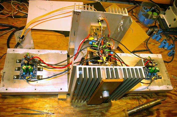

bubba177 said:
has anyone had a hum problem with the F4?
I had such hum problem, first with Son Of Zen, then with f4. Solution:
I always use longer cables to have possibility to manipulate with heatsink and to move position of cables inside amplifiers - it really helps. Very useful are good headphones instead of loudspeakers or voltmeters - you can easy find minimum of hum. The only problem is to keep cables at the position - result looks not elegant, but is effective.
I will try to attach a picture.
a.
hum problem
See attached photo. All cables are long. After assembling all walls together for normal listening, cables are in groups and hung up to the upper corner screws as far as possible from transformer.
a.
