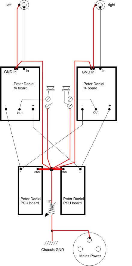

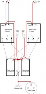

Re: Re: grounding
the amp in stereo - grounding maybe like this:
Blitz said:
Why have you guys not come up with one Star ? Ths looks like two stars attached to each other. If you use the amp in stereo: Where would you connect the Grounds of the ouitput binding: to the first star (input signal or the second (PSU) ?

thermistor to ground
thermistor to ground is more for safety, look at FIRST WATT F1 POWER AMPLIFIER SERVICE MANUAL,
a.
Luke said:the thermistor to ground is to reduce hum right? Should this technique be used on all amps?
a.
Re: thermistor to ground
I think it's to keep the safety, at the same time, preventing the noise coming from the protective earth loop.
Andrzej Sochon said:thermistor to ground is more for safety, look at FIRST WATT F1 POWER AMPLIFIER SERVICE MANUAL,
a.
