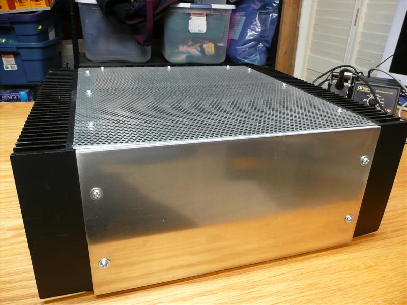

A couple images of my finished F4 "mule" amp with all Peter Daniels boards. This is my test bed before I start cleaning up wires, adding fancy parts, etc. Alas, metal work is not my forte, but it sounds great.

I have my F4 wired up with a single transformer driving a stereo amp. My tranny was initially bought for an AX amp that never materialized. It is a 750 VA 18v primary unit with a CLC power supply and about 65,000 uF of capacitance. The caps are 2200 uF Nichicon low ESR caps I bought on overstock for cheap and strung together on 11 ga romex.
Is there any real advantage to separate transformers for each channel? I have two of these monsters and they will end up driving 2 balanced channels in the end, but just wondered what if any advantage there would be to having two supplies instead of one.

You get the best soundstage, using two trafo's (and supplies). True dualmono gives the best result, marginal maybe, but detectable. If you are building F4 bridged monoblock's, its perfectly allright with one trafo per channel. (Obviously!)
Another point is the appeal factor but thats not important, compared to the previously mentioned reason.
One single AC inlet is quite adequate, though.

where did you get your bolts and washers for this?
Is there a kit for this sorta thing, or did you just go to the hardware store?
I would not mind seeing a close up of the PS, amp boards and rectifiers - looks like you got some quick disconnectors there, good idea.
Did you use 1/2 watt PRP resistors everywhere? Sorry if you posted parts used elsewhere.

Uh, no kits, that's what DIY's about ;-)
I found a local Metal Supermarket franchise store here (GREAT service by the way). I had them cut a 5052 12x14 sheet of .125 aluminum for the pan (~$10), 12x6 .125 for the back (~$7), and 12x14 perf steel .080 on top (~$12). The front is 12x6 0.250 5052 (~$15). The angles are all 1 x 1 x.125 (~$1/ft). I have around $50 in all that, but then there's the 2 or 3 6-32 taps I broke hand threading all of them. That took by far more time than anything. I just don't have access to small job machine shop or friends with those tools. Oh, and a Unibit is worth every penny for the back panel.
I used all 1/2w PRP's except for Mills 5w for all 0.47R in the PS and source resistors. Coupling caps are Panasonic FC's, power supply 15,000uf 35v TSHA's, bridges are generic IR.
This is what I describe as a "mule" for me to test parts and get all the grounding right, etc before committing to more cost. I used the quick disconnects and left all the wires long so I could easily transplant all the parts later. The grounds are all connected using these cool little 6 position push in connectors from the electrical department at Menards. That way I could test how to ground the dual mono. Once it's right, I will use decent wire and solder all those connections permanently.
