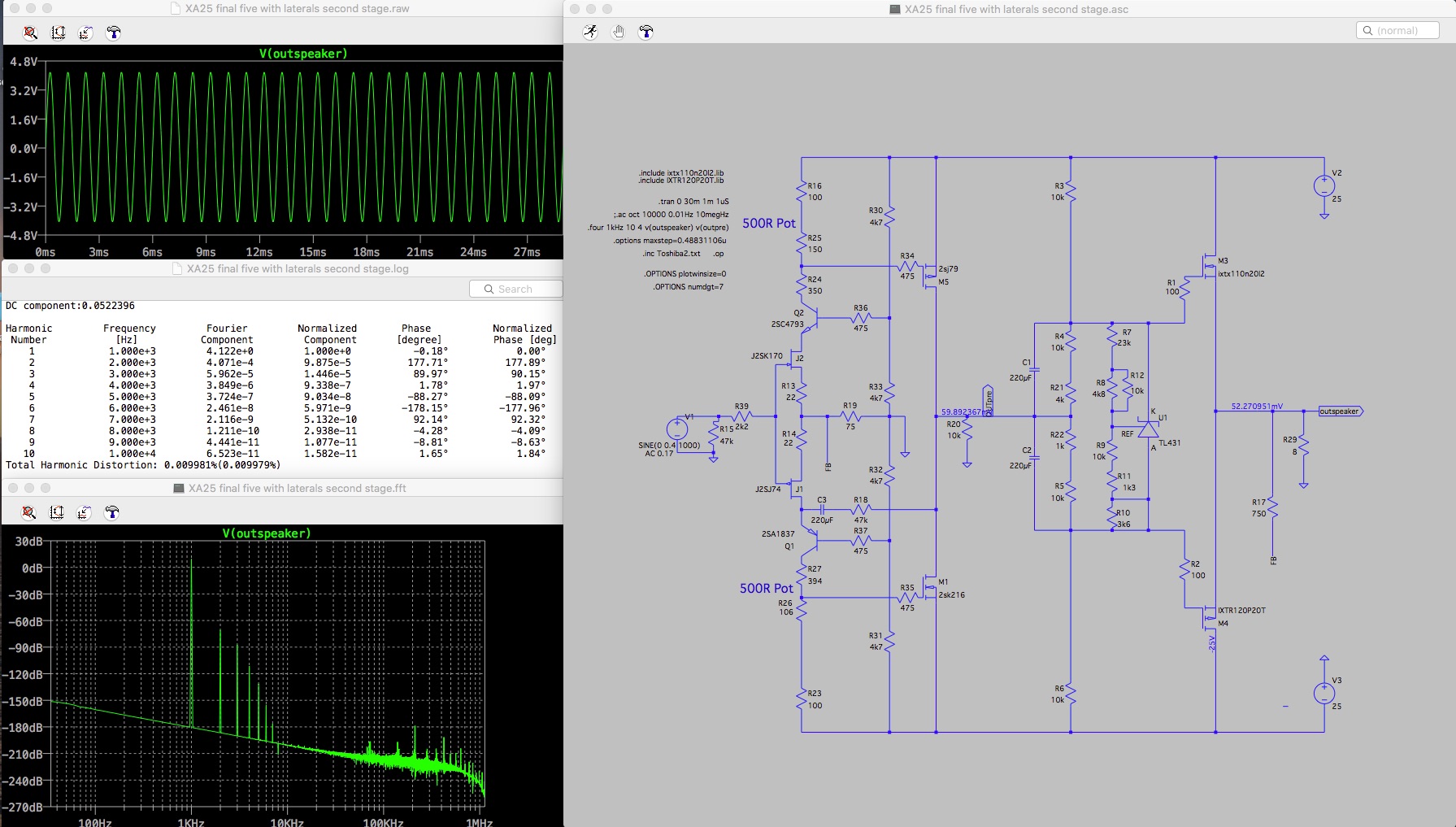

one more of these useless Spice simulations....:D:D
this time with laterals and no degeneration in the second and third stage.
Keep in mind that I use the 22R degeneration for the J-Fets only because my Spice J-Fet models have a high Idss around 11mA.
In the circuit I take "naked" J-fets with 7mA Idss.

and of course the models for the Hitachi may be not really good.

I have matched jfet models with Idss around 8mA if that helps you out.
If the TO220 devices turn out to be fakes there is no reason not to use the to247 devices. They are very easy to drive.
