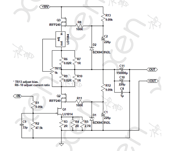

You first have to change the LU1014 triode cell from 1.3A bias to 200mA.
See :
https://www.diyaudio.com/community/...l-fet-class-a-zgf-headphone-amplifier.225577/
Then you can simplify the Aleph current source with a single LM317HV :
https://www.diyaudio.com/community/threads/hybrid-zen-amplifier-lm317-efficient-and-simple.402477/
Of course you need to adjust resistor values to suit your requirements.
Best to simulate in Spice first.
No copy and paste.
Patrick

I f I go with this model I guess I will have learn spice..
This is a power amp for 4~8 ohm speakers.
I already told you how to change it for headphone in post #4.
First is to understand how the circuit works.
Patrick
I am going to scale it down......0.15F on the out, headphones/loudspeakers have 0.25 ohm?..
Maybe better to make something like diamond buffer or "dual-railed" single-ended HPA or something else?..
And F3 will build for loudspeakers?.. Anyway the out capacitor must be excellent quality.
