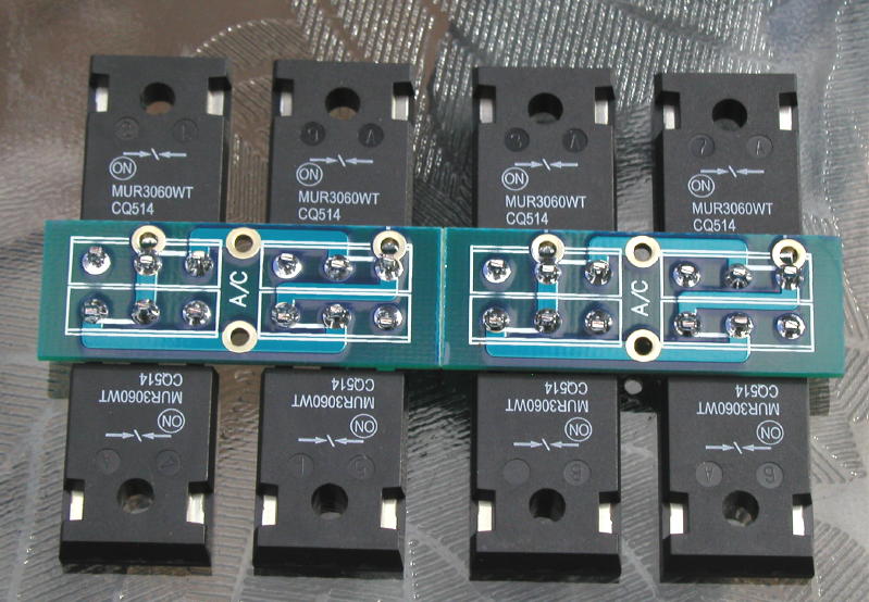

here is the first choice for diodes: I saw these recommended in one fo the threads for your PS (links are to the manufacturers data sheets):
mouser p/n 844-MUR3020WTPBF
and here is a second one that seems very similar:
mouser p/n 512-FFA40UP35STU
but that one is about half the price.
And could we not use the MSR860 ones?
about half the price again.......
Fran
Fran
Mouser carries those resistors too: http://www.vishay.com/docs/31018/cmfind.pdf
I will probably start with MUR3060, but I got them as samples.
Instead of MUR860, you may consider MUR1560, they are rated 15A and may be OK here?
