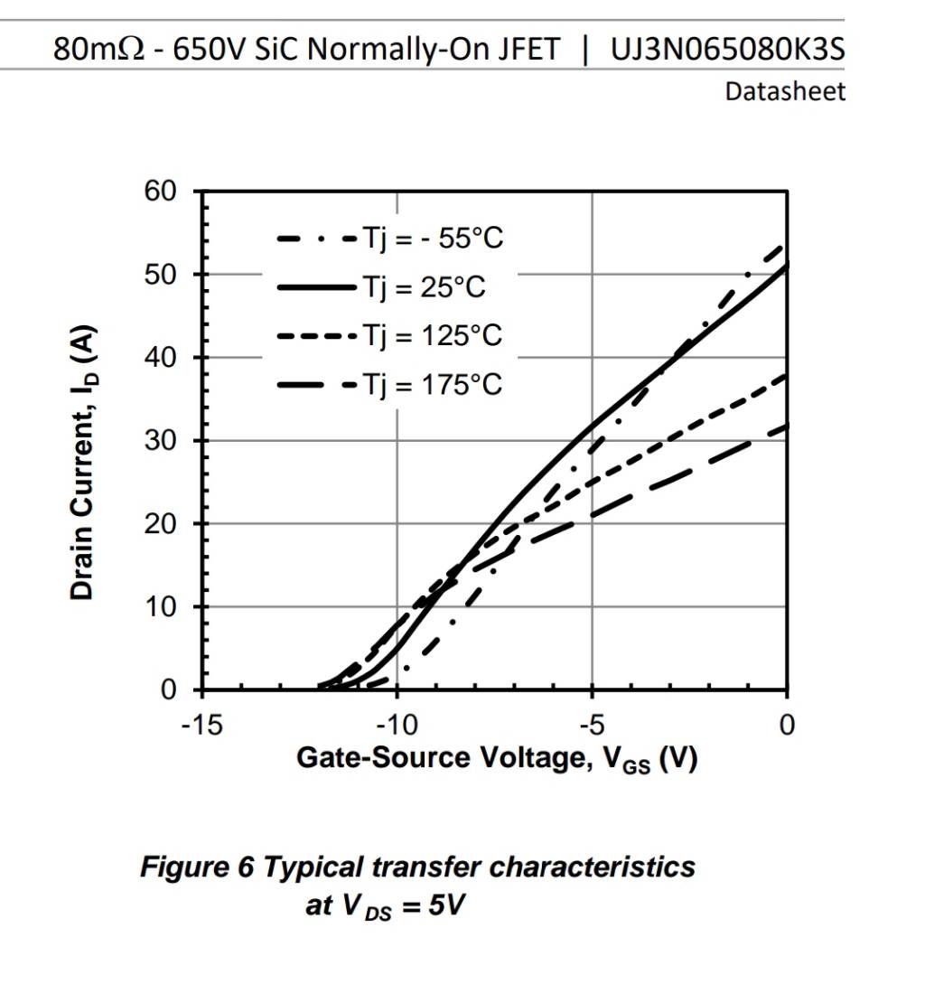

I have looked at this part before but it is not workable. The input needs something like -10V to get it to do about 2A. So either you add in an extra supply for biasing or you raise the source voltage to 10V ....
Oon
Joined 2017
Do you have the transconductance data?
Just what's in the datasheet I referenced. I'm not skilled enough to determine if it looks like a possible replacement. I was wondering if anyone else has experience exploring this option.
So it sounds like at a minimum some changes to the original circuit would need to be made. Which I assume isn't surprising.
