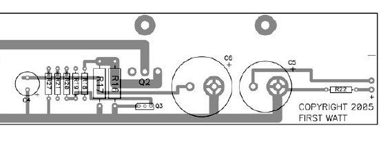

Hi Peter,:)
I got he boards and I am building them up..:):)
one question please ... C4 and C6 are both 15.000uF but the place for C4 is much smaller than for C6.:eek:
The same is true in the service manual of Nelson.
Is it possible there was a change in the values later.....?:confused:
thanks generg:D
I went with original board layout where C4 looks like a smaller bypass for C6. I don't think there were any later changes.
