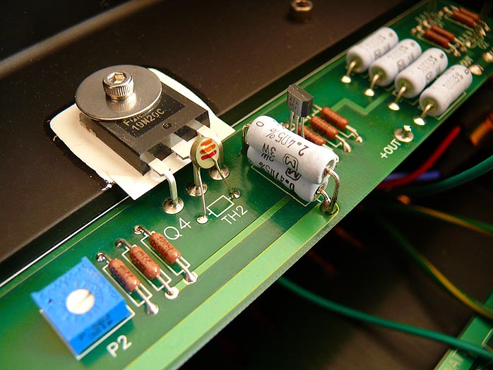

Sorry to revive an old thread but I was looking up info on the heatsinkusa 10.08" heatsinks for an F5 and I noticed this comment. In the documented builds I noticed everyone pushes their thermistors onto the case but looking at a photo of the F5 from 6moons it looks like Pass is measuring temp from the center lead (touching? or just very close with a slight gap?) Anyone know if there truly is a difference? Thanks.
