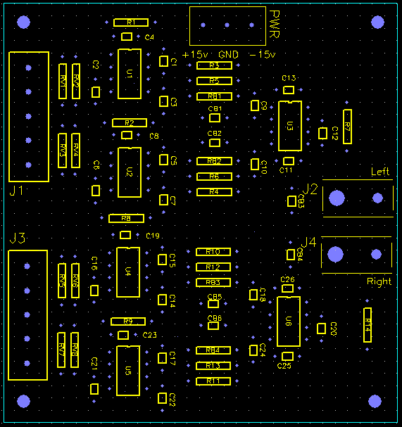

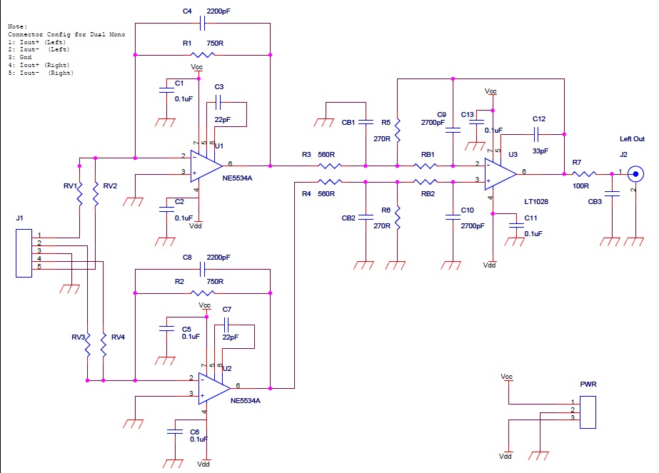

Hello,

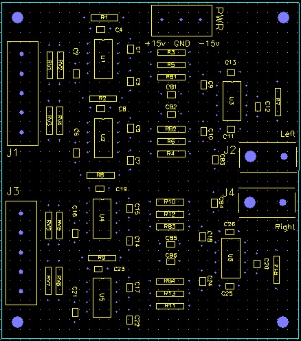

I am building a ezDAC and thought of building a IV convertor with summing stage myself. Here is the schematic which I came up with. It is customizable to support Dual Mono and can work with different filter types.
I am planning on making a PCB for this schematic and open to suggestions / comments.

In my search for "Clean Power Circuits" to feed the Digital and Analog sections, I recently reviewed a document: "Power Supply Noise Reduction" which you can download (PDF) from "The Designers Guide Community" web site. In addition to discussion on Supply bypassing and decoupling... from which I learn that it was best to keep tracks really short, and with the onus on keeping return paths close to the send path, it also covers OP Amp coupling/decoupling choices as being critical.
My plan is to leave the buffer (I/V receiver) OP Amp in it's compact real estate on the EZDac board, simply because I do not feel the risk of increasing RF noise is worth moving that component to the Headphone Amp board (read my lack of confidence here).
I looked up the LT1028 Data and find it to be an excellent choice... in meeting one main criteria which IMO parallels the importance of a well designed circuit board (RF interference free), and that being the settling time. Your schematic print is small, so could not see the part number on the other OP Amp (NE5634A ? could not internet-find a data sheet on that one).

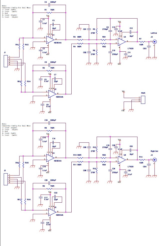

Hi Louis
The other op-amp is the good old NE5534A. In fact I just completed the routing the board and its about the size of 3x3.5in. I am still debating on whether to include a clean power supply section along with the board.
I have attached one half of the schematics in a readable size.

Looks very good, this topology can be used for lots of current-out DAC's. Personally, I wouldn't pick the NE5534 though . But if you fit some sockets, you can do some opamp-rolling, it's a lot of fun and can be very revealing!

Looking at the ezDAC board, the I/V resistors are advantageously close to U3.
Would it be OK to use those positions rather than place them some distance on the HPhone Board? I may be off track when considering the benefit of a voltage signal vs a current feed over some distance? The current running to the adjacent board creates a magnetic field around the "longer" conductor; such field would be of a lesser intensity with the smaller current drawn by the receiver OP Amp if sensing a voltage feed on those same conductor wires? Is the very nature of capacitance and inductive coupling problems not current dependent? On the other hand, RF/AC fields (any frequency) are lazy by nature and will prefer hitching a ride through a shunt like a copper track/wire, thus inducing noise current... so which approach would be less risky for noise pick-up?
Louis

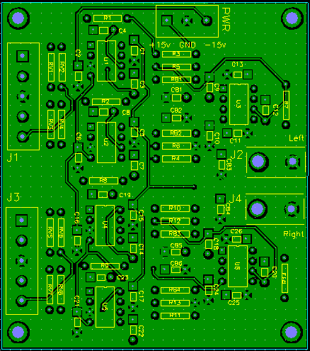

Ray for the very same I decided to use DIP package on the board which gives you an option to playaround with OpAmp of you choice. I will post the board design images.

I understand your concern about the capacitance and inductive problems. I have done some experiment in the past and as long as you keep the wires as short as possible and avoid crossing power supply wires, then you should be good.
Another interesting thing with this design is, its easy to get a differential out if you use two of them.

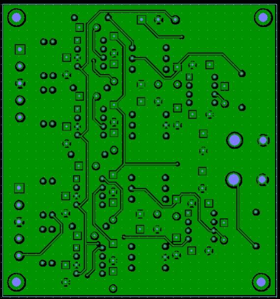

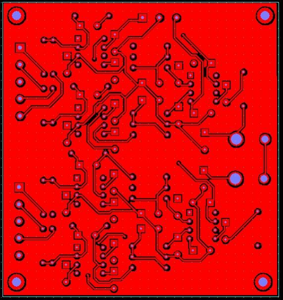

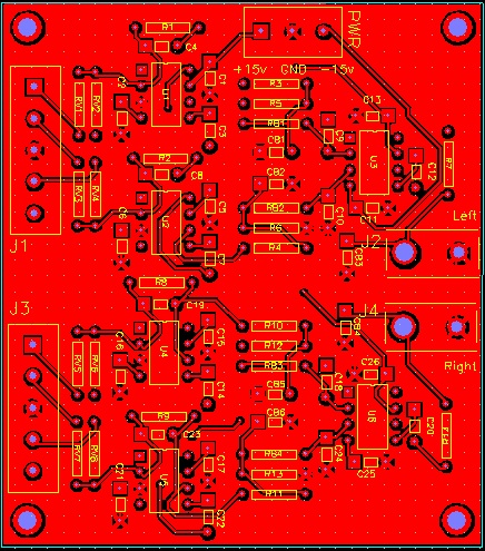

Looks good, but it looks like your TOP layer groundplane (red) is not connected to anything. There's a long trace running on that layer connecting all the ground points, but that's actually not needed as everything is already connected through the BOTTOM layer copper plane and plated holes. Are you using a netlist from the schematic? Otherwise this wouldn't be possible.
Ray
