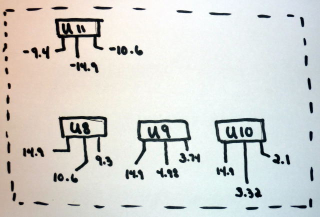

You are right I screwed my drawing up U8 on the dwg is really U10, and U10 on the dwg is really U8.

- All the voltage regulators U8,9,10, and 11 are putting out the correct voltage, except that U10 and 11 are putting out +10.6v and -10.6v instead of 12v. but thats just a resistor change to correct.

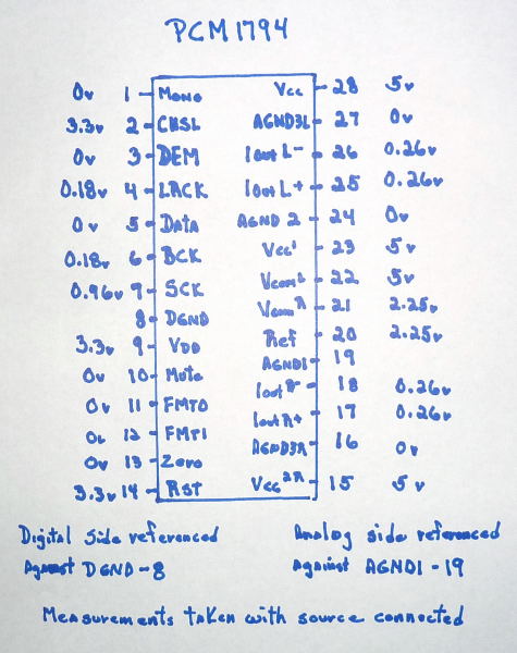

- PCM 1794 : getting 3.3v on legs 2 & 9 as per diagram, getting 5v on 15,21,22,23 & 28 as per diagram.

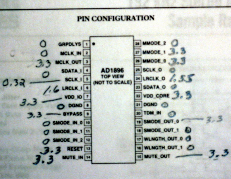

I tooks some readings tonight with a digital source hooked up and running to the EZDAC. the PIC below shows what I got. The reset voltage was on spec. Do you think that its something upstream that's at fault ?
PJN
Most voltages look o.k., only Vcom at pin 22 is not correct. This should be 2.25V, just like the other channel. I suspect you skipped a pin writing down the voltages. I don't know what REF at pin 20 should be. If you check and still find it's 2.25V, I suspect a short to Vcc could be the problem.

You were right, I rechecked pin 22 on the dac chip and got 2.25v. Those legs are really close together and I must have hit the Vcc. I took a set of readings on both the AD1896 and the CS8416 and have attached them below.

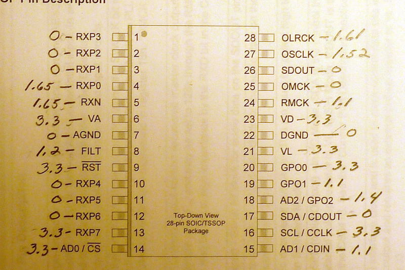

I double checked things tonite, on the CS8416 pin 12 was 3.3v, and on the ASRC pin 9 was 0v and pin 10 was 3.3. Those damn pins are so tiny and numerous that I find it easy to get lost.

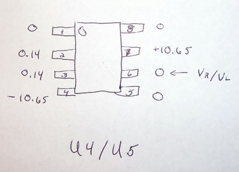

I checked U4 and U5 also, the results are in the pic. I noticed that even though I had inputs and voltages on pin 6 (Vr/Vl) I had no reading on either. I used the LME49710MA which was the alt on the BOM. I checked the legs carefully for shorts and bad solder joints but all looked good. Do you think I got a couple of bad chips ?

The readings on U4 and U5 are o.k. The opamp only amplifies the difference between it's inputs, so it's normal that you don't have any output on pin 6, since both 2 and 3 read the same.
But the clock voltages are not o.k. Pin 4 Vdd should read 3.3V and this may be the error that is keeping your ezDAC from singing! Without supply voltage, the oscillator won't do anything and there's no clock for the DAC. There's an SMD ferrite bead on the back of the board (F2) that transports Vdd to the oscillator, maybe it has a bad connection?
Ray
