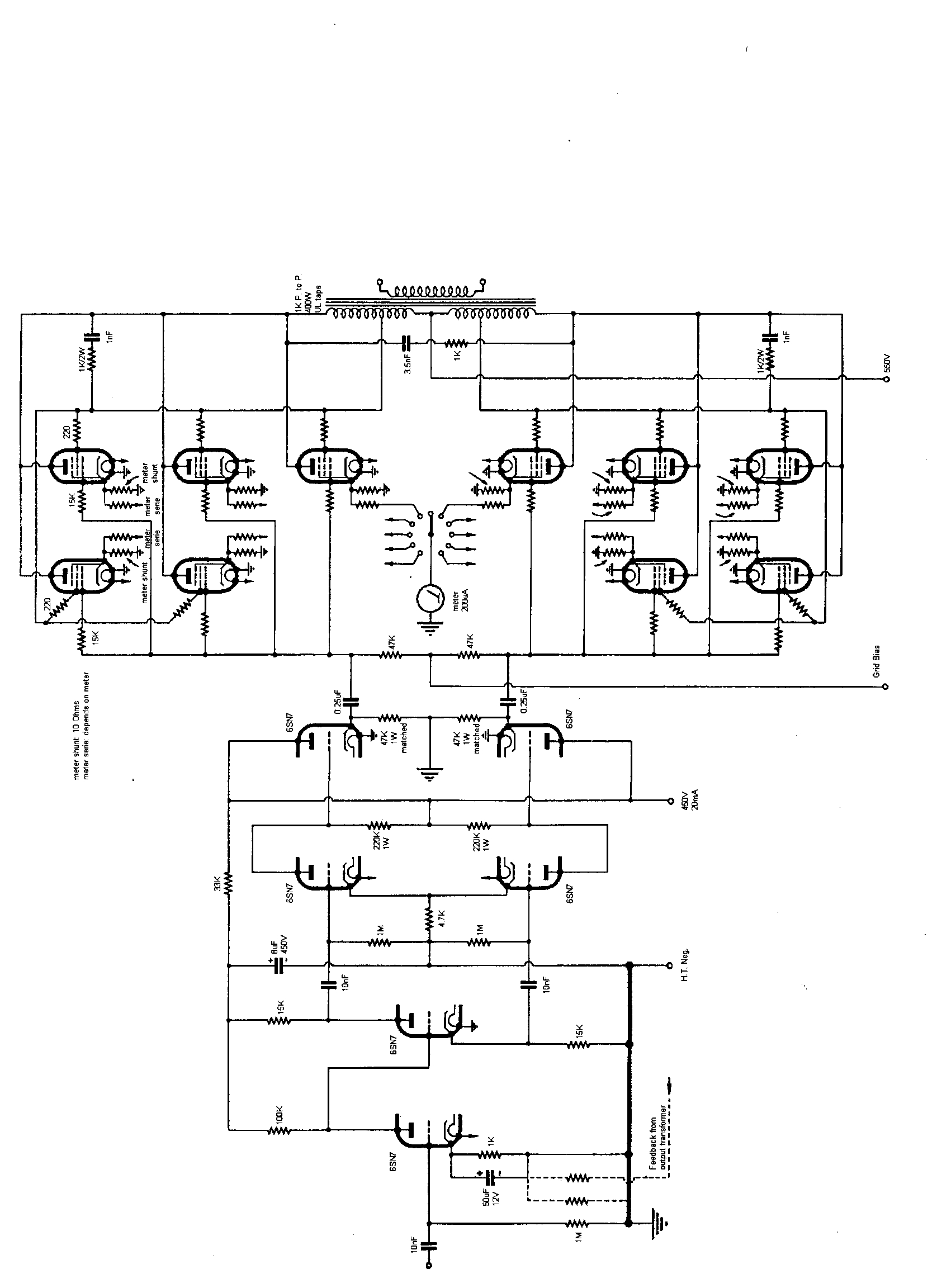

GEC 8 x kt88
Circuit of GEC KT88 x 8. I built it using 4 x 6550's. The original uses GXU1 rectifiers, but have found you don't need choke input, silicon rectifiers with cap input give excellent regulation; I used an adjustable load two 3k 200 watt pots.to test the power transformers. I guess even better if your power tran has sufficient voltage to use choke input.

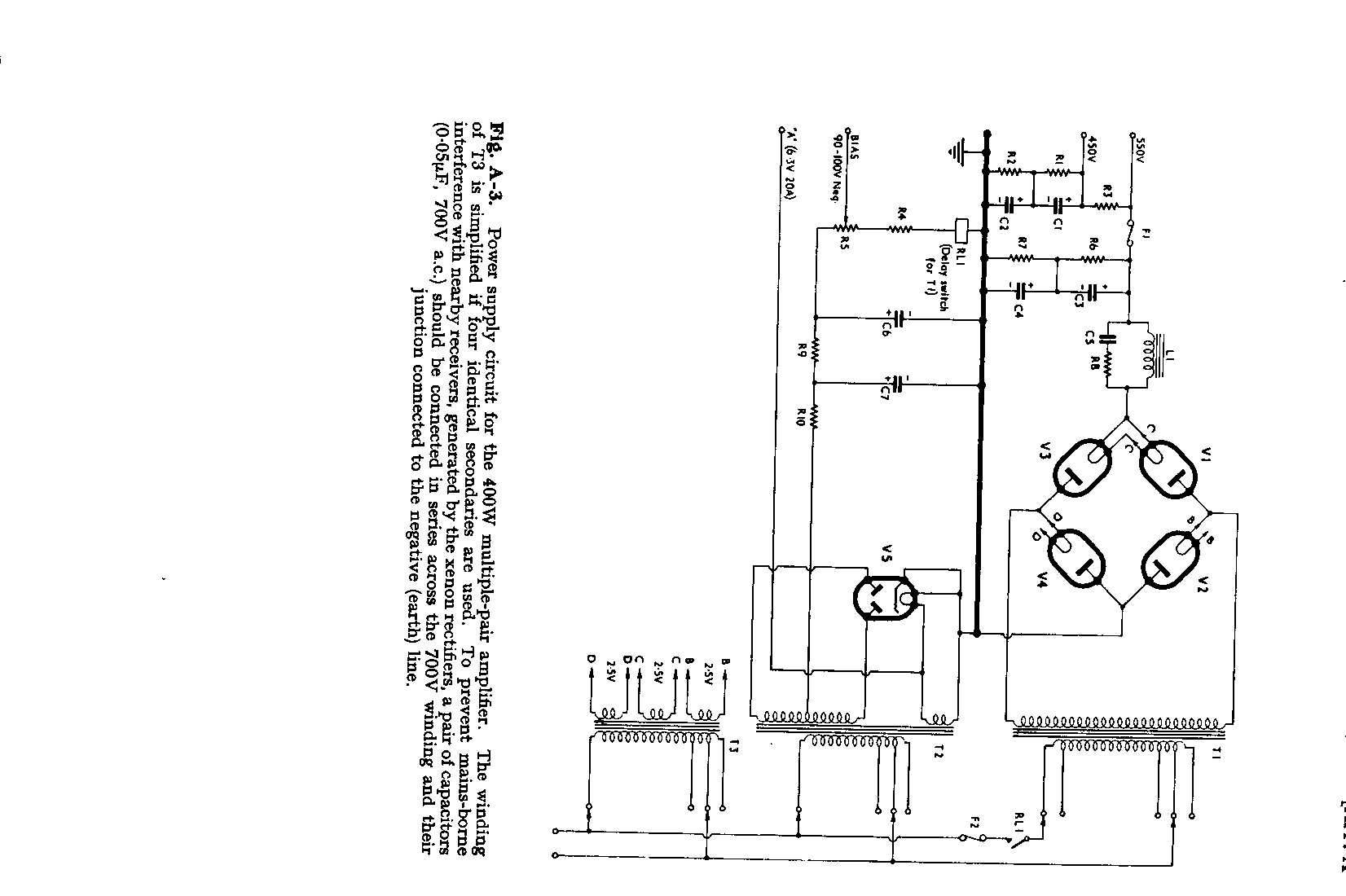

That GE circuit with the 10 x KT88s .......
One needs to be more careful. It feeds 47K grid resistors from 47K cathode follower loads? No voltages are given, but that makes for a nasty ac load on the drivers. Unless one has more current through the drivers than the 3,7W dissipation for 6SN7s will allow, quite a bit of distortion shows up from the load lines. OK, they are cathode followers, but it is not wise to have distortion from the basic topology and then glibly cancelling it with feedback. (That apart from 47K grid resistors for 5 x KT88s in parallel?)
The solution is not easy. With a required grid drive of some 50 - 60Vp signal, one is approaching using power tubes for drivers or increasing the h.t., or using several triodes in parallel for drivers as someone suggested. As said before (I think!), I ran into such a difficulty with four 6L6s, and had to revert to a servo circuit to keep the power tubes from running away. (In my case I needed 300K min. required for grid resistors without which the drivers would have generated excessive distortion).
In this modern era there is no excuse for shoddy drivers and/or excess grid 1 to 0V resistance. Use one Mosfet Source follower per output tube. Current Source load the source followers, a "ring of two" bipolar transistor current source is adequate. Apply the bias to the gate of the mosfet. Choose MOSFET drain volts to keep a minimum of 25V across the mosfet on peak positive signal drive (so that Crss modulation is minimized). Returm the current source to a V- of at least x3 the bias voltage. Use a mosfet of only as large as you need NOT an IRF820 etc. (You want small Crss).

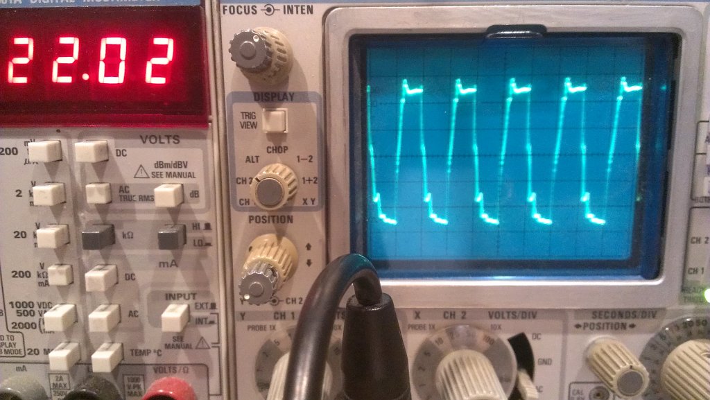

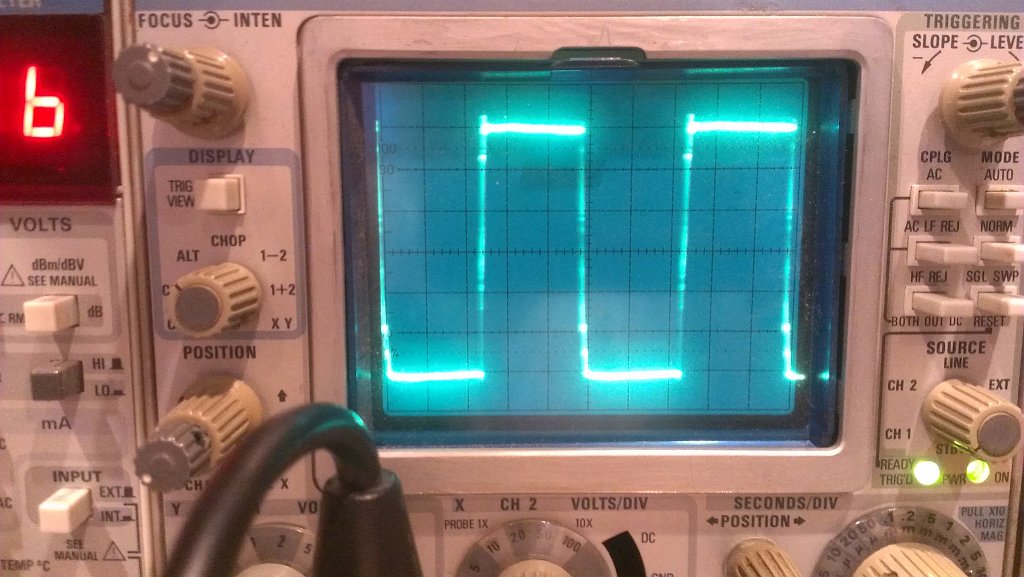

Looks great at 1khz, looks bad at 10khz. This is with the KT120's in it, which I'm waiting for a cool down then removing. 1khz was at a reading of 30vac on the meter and the 10khz was about 22vac, gets ugly as it approaches it.
Here are the pics for the KT120's, these are also biased a bit low at .060ma at 500v.
Edit : KT88 look similar, seems some ugly signals as the frequency goes up at power. Sine wave gets pointy at 10khz when you start driving it with 50watts+

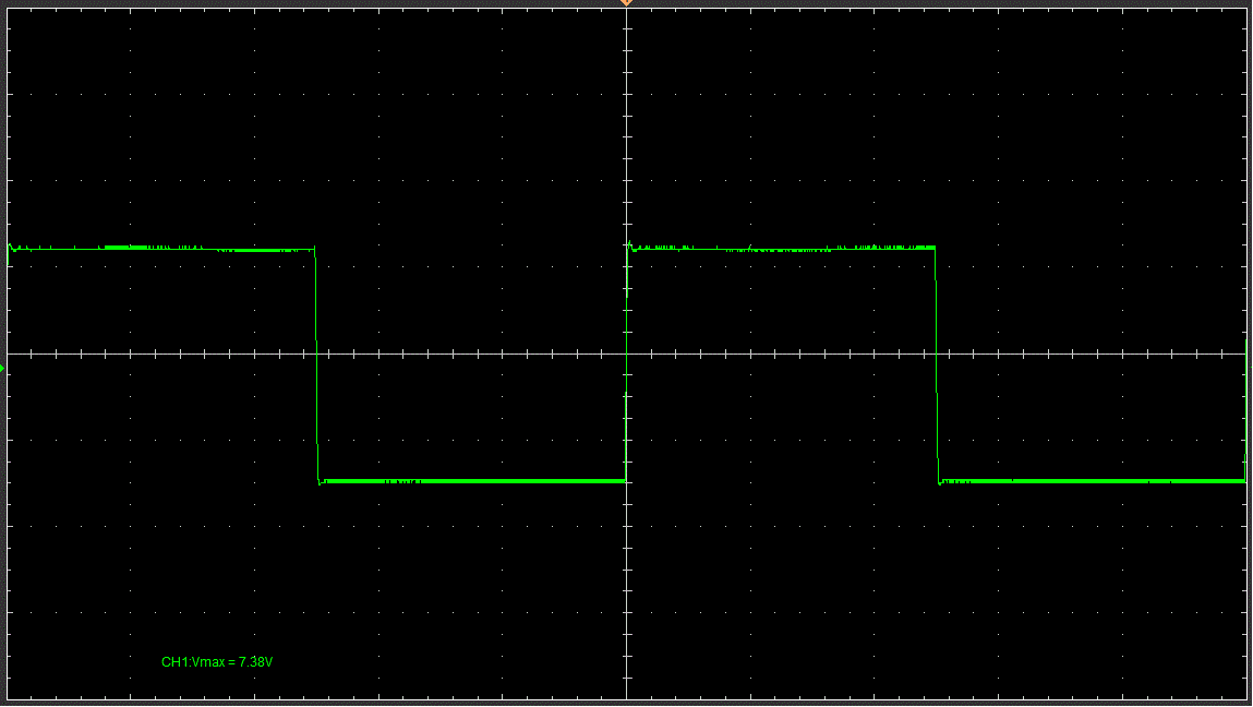

Use about 1/3 power for a square test. At 10k, it should look much cleaner. Also, phase compensation circuitry needs to be introduced to stop the ringing.
From the data you posted it looks like you may have stability issues. The square wave in my amps with heybor transformers looks almost flawless with my driver.
SandyG,
In my post #43 I promised to have a look at the various load lines. I do however hesitate to continue; it will certainly not do to dump a lot of diverse suggestions on you by folks you do not know - or stuff you could very well have calculated for yourself.
Being thus cautious, may I nevertheless put forth the following results from analyses done by me:
The relatively low current through V6 (referring to one channel only) in the presence of an uninspiring load - some 60K in parallel with 47K, gave intuitive suspicion of a problem. Load line analysis shows that you may be running the cathodes 'into the ground' at about 80Vp signal, and at least incur noticable 2nd hrmonic distortion at the 50Vp odd signal required to drive KT88s.
Inspection shows that one can take R31, R37 down to 15K with advantage. The plate dissipation of each triode will then be 2,8W, still comfortably within the 3,75W allowed. R31-R37 will run at 2,5W each, necessitating wire-wounds for safety*. For a good operating point, to keep negative signal excursions well away from Ia=0, the cathode voltages need go to about 190V, bringing the plate voltages of the previous stage to some 184V. For this R29, R35 will have to go to 5,1K. R30, R35 can remain at 220K.
I was unable to do THD measurements; my analyser reposes on the shelf at present for repairs and I do not now have 6SN7s.
I also had a look at the seemingly unimpressive square wave response (only remember that any distortion at 10kHz will be at 20kHz and above; not audible.). Still, it would appear that you have two influences here: Some slight oscillation at about 90kHz, and a somewhat early loop gain attenuation at about 30kHz. R60-C30 does come in at about 50kHz, but not continuing the cut as a result of a relatively large R60.
But the feedback correcting capacitor C17 (over R19) only starts to act at 1MHz! You could thus first try to increase that to 200+pF; that compensation might lift the leading edge of the square wave. (Looking at a 5kHz square wave will more than suffice.) If you can get a 250 pF variable ceramic capacitor, and carefully mount it in place of C17, you could watch which position gives the 'squarist' response and build up from there. (Only keep hand and other stray capacity in mind.)
The remaining 80kHz wiggles I would associate with the output stage. You could experiment with the RCs from G2 - Anode. (Warning: High voltage!) Treat these two phenomena separately.
I hope these notes may be of value to you!

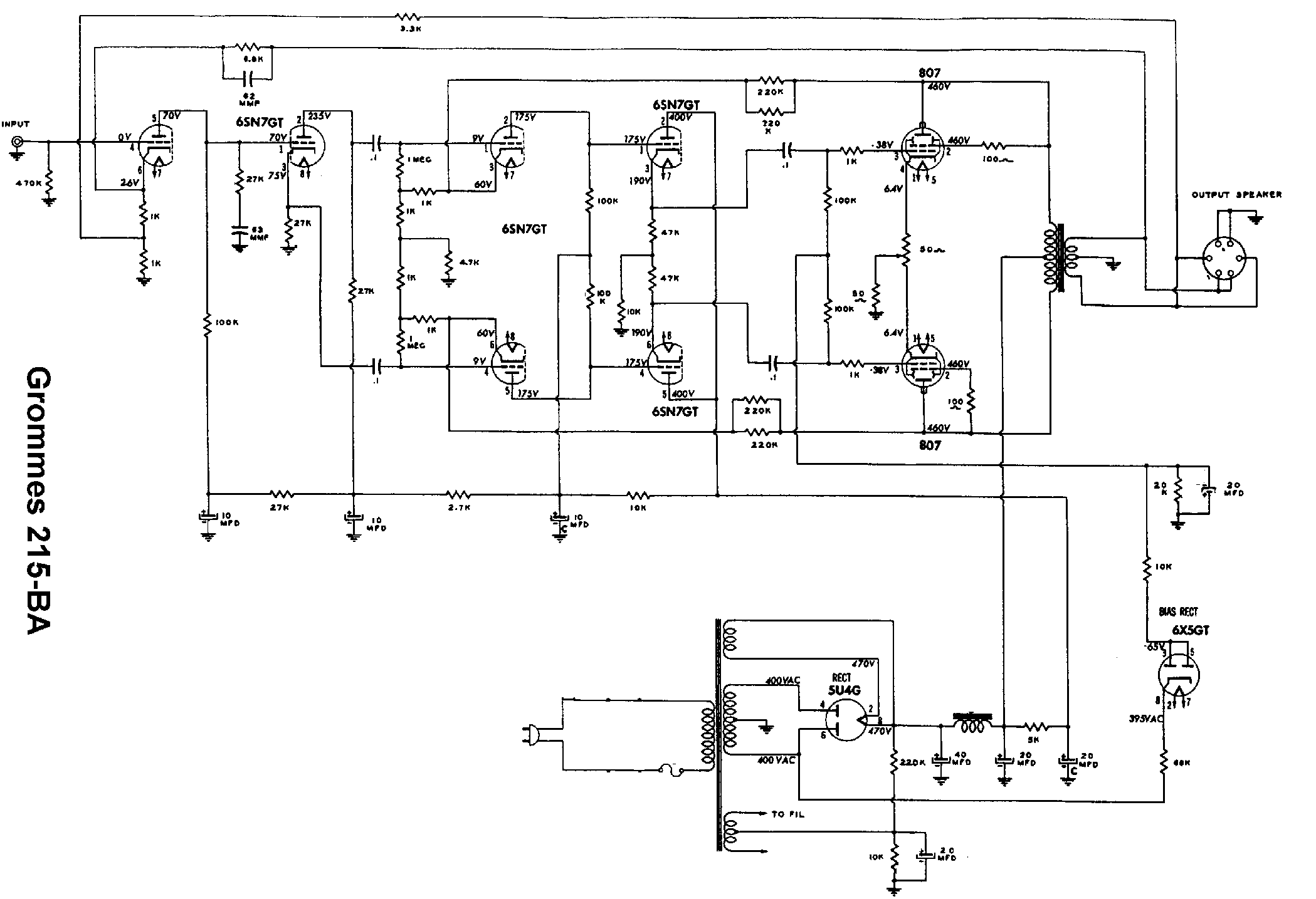

Johan -
Thanks so much for the detailed help!
It will take me a bit to understand them all.
One thing that I think is a bit problematic is the voltages to the 6SN7's, mainly the Cathode Follower since I think it is sitting right at the limit of Heater to Cathode for the 6SN7's. The Grommes 215A puts DC on the filaments and have that option but figured better to keep a safe levels. The Grommes also uses a bit different resistor set up for the Cathode follower and in retrospect I should have allowed for that in the circuit too.
To me, it also looks like the first stage (input) B+ is low in voltage, potentially a bit low in bias as 2.9v, but in looking at the 6SN7's curves at that voltage and 1.7ma it's in the lower end of the curve which I am guessing is not a good place for it, but the Grommes is also lower that I would expect.
For the compensation network C30-R60 I was not going to use that at all but will change that back to R60 of 27K where I think the Grommes Had it.
I may also small HV trimmer that could work for optimizing the feedback network.
Is it better to start with fixing voltages on the 6SN7 B+ then try some of the other changes?
Again, thank you for the very detailed help!
Sandy

That looks a tad bit cleaner! I reduced the voltage a bit and it looks much cleaner but other things need to be adjusted a bit. I think some of the mentions by Johan are what you were saying also...
Sandy
