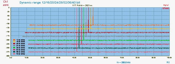

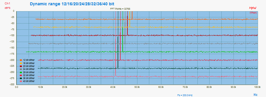

Here some various bits .... :D

Noise floor of 16 bit dithered signal is only -65 dB ? :confused:

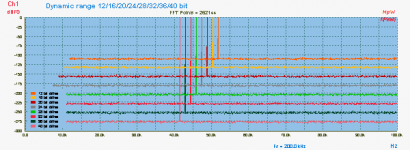

Thank you pointing out about this! This graph's are as 3-D just using same stimulus frequency and using in addition an 3-D Y-offset too!
Here is the graph's without the applied Y-offset! :D

  • HpW-Splash reference Noisefloor using 12-16-20-24-28-32-36-40 bit 3D-A7e-clear-off.png
