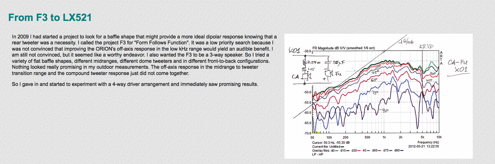

Guys, I'm relatively new to home DIY builds, although I used to install my own stereo systems in cars in my younger years. I'm looking at a similar design, but using Fountek X3.0 ribbons for tweeters, and Infinity 1262w for woofers. I'm planning on going fully active using a DBX, with the exception of passive from upper to lower mids.
Thoughts? For the passive, are you guys just wiring the upper and lower mids in parallel? In the original design, I note one speaker is 4 ohm while the other is 8 ohms. Wouldn't this equate to 3 ohms parallel?
The Infinity 1262w were originally designed for cars. Think it'll work here in open baffle?
Thanks, John
Linkwitz and i use a passive crossover between the lower and upper midrange.
This response is then equalized. I use DSP.
Here is Linkwitz circuit. The upper midrange is reversed in my version too but i use different values.
The impedance is the complex sum including the crossover.

Thanks Joachim. Just so I have this correct, the upper mid and lower mid are wired in parallel? Except that the upper mid "+" and "-" connections are reversed? Are you pretty satisfied with the sound of your design? I have 22 year old Infinity Kappa 8.1, so am hoping this build will be better. Thanks, John
This is a simple 6dB crossover and yes, the upper midrange is reversed.
I do it the same but use other values and drivers with higher sensitivity.
As you see the result is not flat so it needs EQ.

I am running active crossovers (DBX234), but don't have an EQ and am not planning on using one. If I double up on the upper mid (use 2 per side) so that the sensitivity is almost equal, do you think that should solve the problem? Or is the flat spot within a very specific spot that you really need an EQ? John
Thanks. I will have a look at the link. The problem is that I already have a 4 way active crossover. I don't mind paying $150 for Mr. Linkwitz's plans, but don't want to pay $1,000 for the ASP when I already have a good active XO. Do you think if I add a Behringer Ultragraph 31 band EQ, that will do the trick? Or do you really need the ASP or DSP?
You don't need to buy the ASP. In the long term a DSP based crossover will be the best solution, SL is already recommending a miniDSP solution. You can always sell off your existing crossover to get a miniDSP based solution
Bottom line is that if you want to build the LX521, you need to follow SL's official plans not only for the cabinet and drivers, but also for the crossover.
BTW, where are you based? There's a LX521 being built in Chandigarh with a miniDSP crossover.
I would love to see / hear the LX 521 in Chandigarh, but it's a little too far north for me. I'm an expat living in central Mumbai. No offense to Mumbai, but I do miss my home town of Honolulu! I have no problem buying the plans. It's the ASP or DSP that I don't want to buy. But I'll reconsider it. Thanks, John
The Linkwitz ASP and /or his Mini DSP solutions are more then just some eq. They are the crossover of this system and is the very heart of the system. Do this part wrong and you'll end up in a terrible sounding loudspeaker. The Eq's are very specicifc for the driver/baffle arrangement. It's completely hopeless trying to emulate this with a 31 band equalizer, so yes you really do need the proper ASP or DSP settings.
