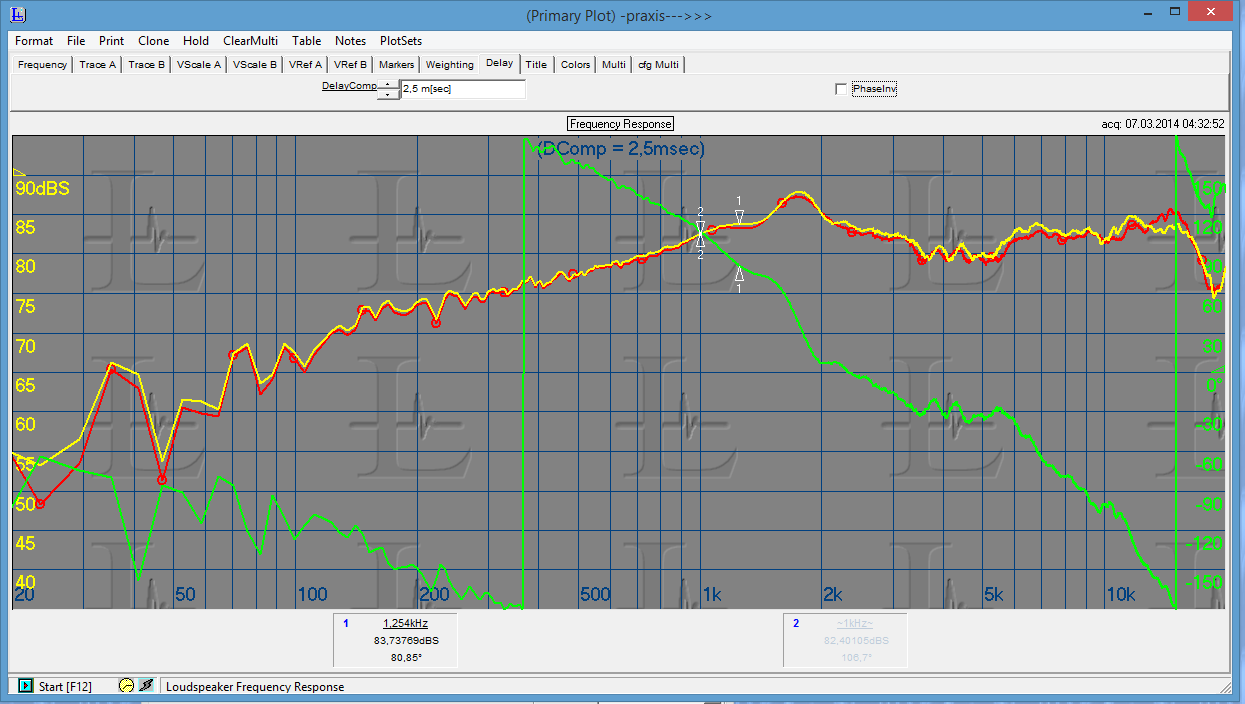

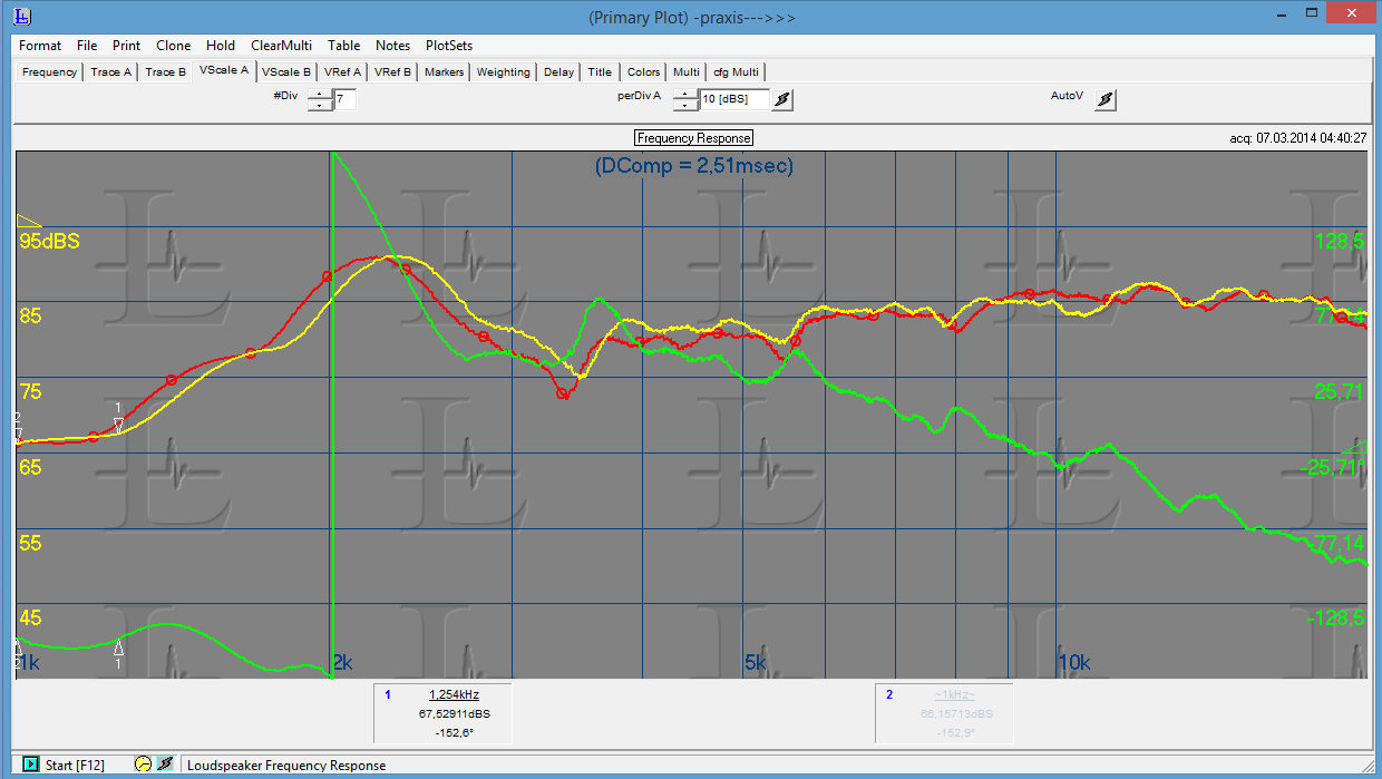

I have now made a pair of midrange-treble panels.
The measurement show left overlaid with right channel.
The first measuement is the midrange, the second the treble.

Your measurements and listening impressions of the dipole Mundorf AMT will be of interest to many dipolers. Do you think you will have the curiousity to build a mid-tweet baffle with dual domes like the LX521 for comparison? The mini-DSP should simplify the work.

I presume the curves you show are 0 degree ? Taken from the listener position ?
Higher Mid have a beautifull curve, i like the little dip in the M-F curve where the ears are very sensible.
I have two questions please :
- With 7000 hz LP for the tweeter, do the upper mid not have directivity problems in its higher range ?

Eldam, yes that 7kHz crossover is rather high. I would theoretical prefer a lower crossover, say 5kHz. Again, i can only say that Linkwitz system sounded much more coherent then any 3 way, notwitstanding 4 way, i ever heard.
Maybe a bit beaming in the upper presence is even an advantage.
