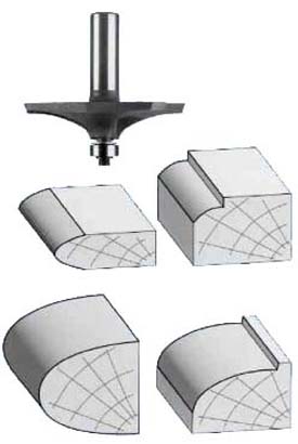

For Supra-baffles, I like to use a "golden ratio" ellipse (very easy with a CNC ) with "Thumb-nail" profile routed edge (you want a big-boy router such as Porter Cable 7519 to machine those without chatter)
I like the elliptical 'look', but they too have pretty strong eigenmodes. Amorphous shapes are best, but not very attractive. Salvador Dali's timepiece comes to mind: Salvador Dali - WikiPaintings.org
