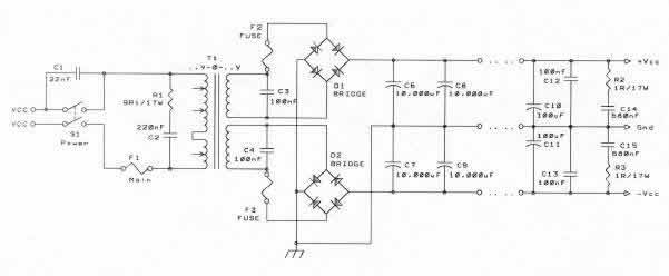

If I build an amp with an external supply, should the rectification and cap bank be inside the amp chassis or outside with the transformer? I have room for the caps but not the tranny.
I was not sure if there was an advantage in a power cable with AC or DC.
The answer was given elsewhere, but not quiet outlined well in terms of reasoning.
1) You MUST have a reasonable amount of capacitance near the actual amplifier circuit (how much depends on many issues).
2) You must keep rectifier and reservoir capacitor in close proximity, to keep the current loop tight.
This implies to place the rectification and the bulk capacitance either in the amplifier or in the supply box, but under all conditions a considerable amount of capacitance should also be in the amplifier chassis.
An obvious option is to use multiple reservoir capacitors with some extra choke filtering inbetween, where rectifier, input cap and filter chokes are in the PSU chassis and the amplifiers PSU capacitors in in the Amplfier chassis.

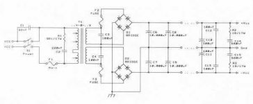

This is in line with what I thought. My supply should look like the jpg below. The cord will be at the break in the schematic. I also planned on using chokes for the +/- rails inside the amp chassis.
You have all been helpful.
