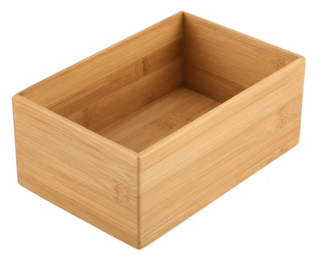

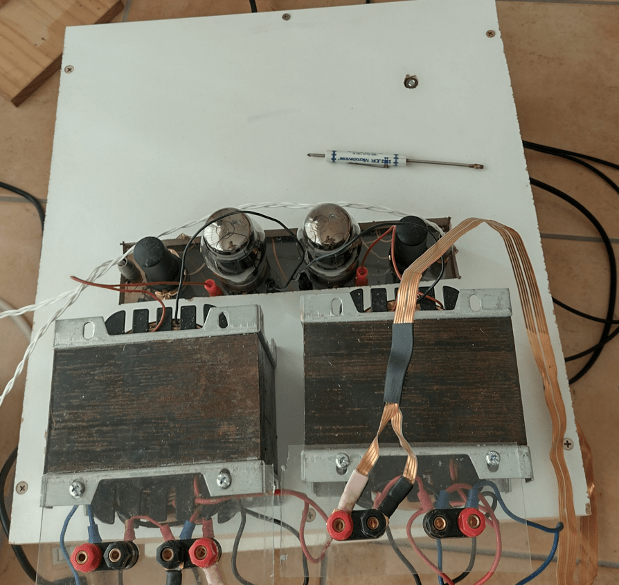

This was just a test version. In my next version, I will enclose each in its own upside-down wooden box and lay them on another larger box containing the rest of the amplifier. Hopefully, the wood varieties will be the same.
A bamboo box from Kmart.

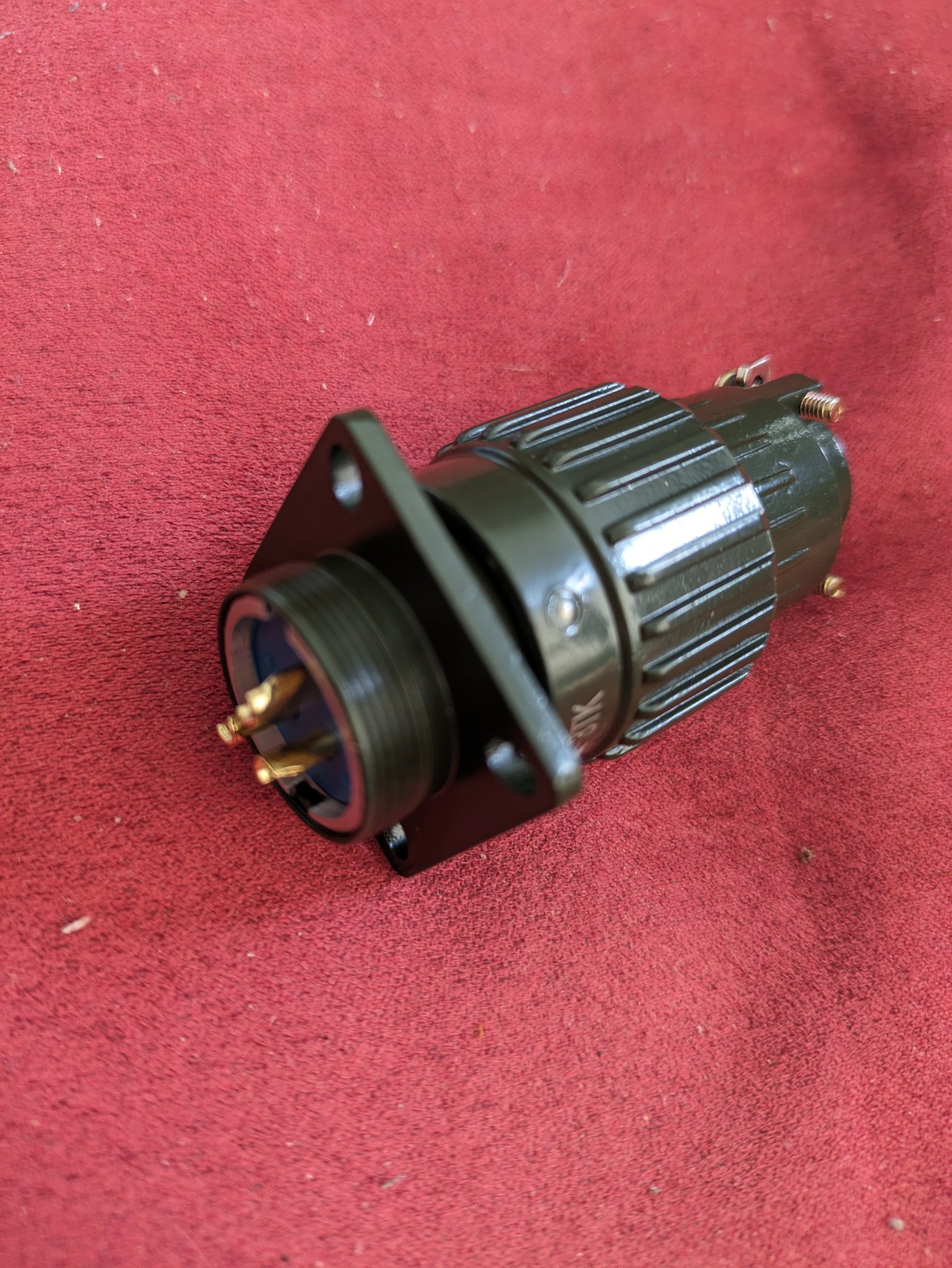

Connections will be via these Y2M-3TK connectors.
The square connector half will be attached to the top plate of the large box with two short wires going to the HV power supply and the tube plate. The two HV wires going to the transformer will attach to the other half of the connector. The connector has a locking mechanism and will be hidden by the top box. The speaker connections will be attached to the small box.
Testing is a problem since I can't turn the assembled amplifier upside down. This can be solved by an extra pair of the same model of connectors linked by two appropriate-length temporary wires.
My biggest problem will be finding appropriate size boxes made of a similar wood to the top of the amplifier.
