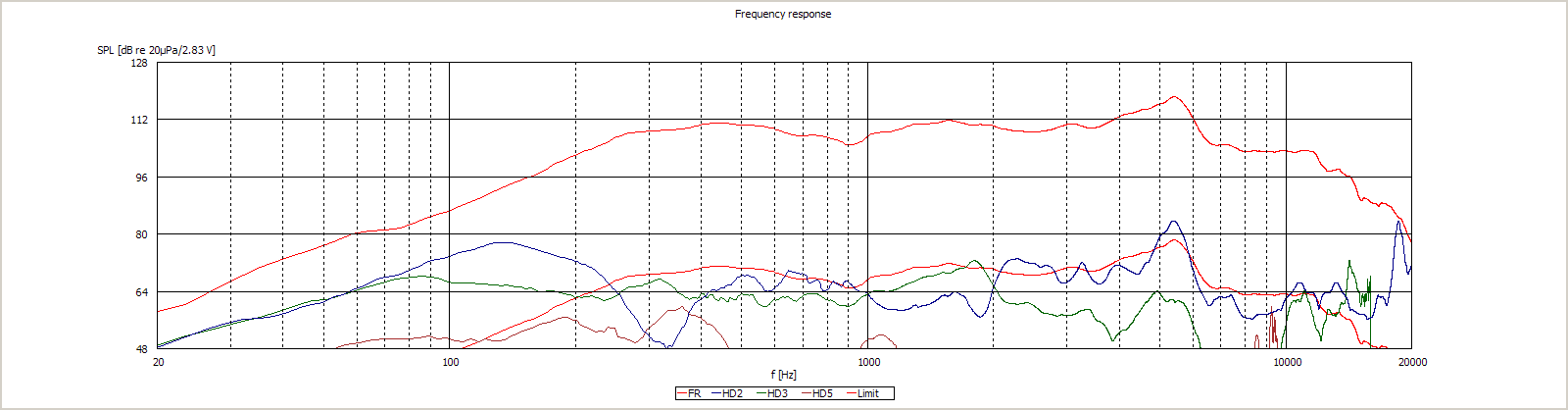

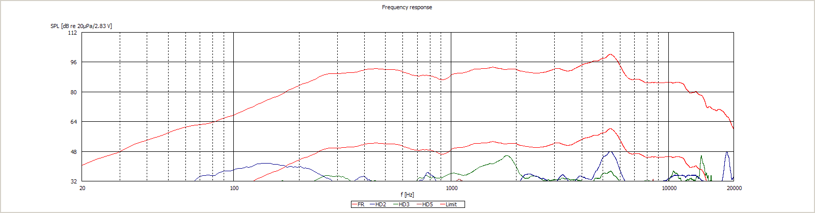

As you're from Italy, I believe you can easily get this fine piece: Faital M5N12-80
I measured one piece of them just yesterday, see attached graphs.
Measurement conditions: anechoic room, baffle 60x50 cm open (that's where the drop at 900 Hz comes from), measurement distance 50 cm (level corrected). The levels are real! So these graphs are really at 90 dB and 110 dB! Because of the open baffle, there's a little gain between 300 and 600 Hz, so the distortion are a little lower than in a closed box.
This driver has 94 dB/W efficiency (8 Ohm), and I would not cross lower than 300 Hz, if you want high SPL 400 Hz.

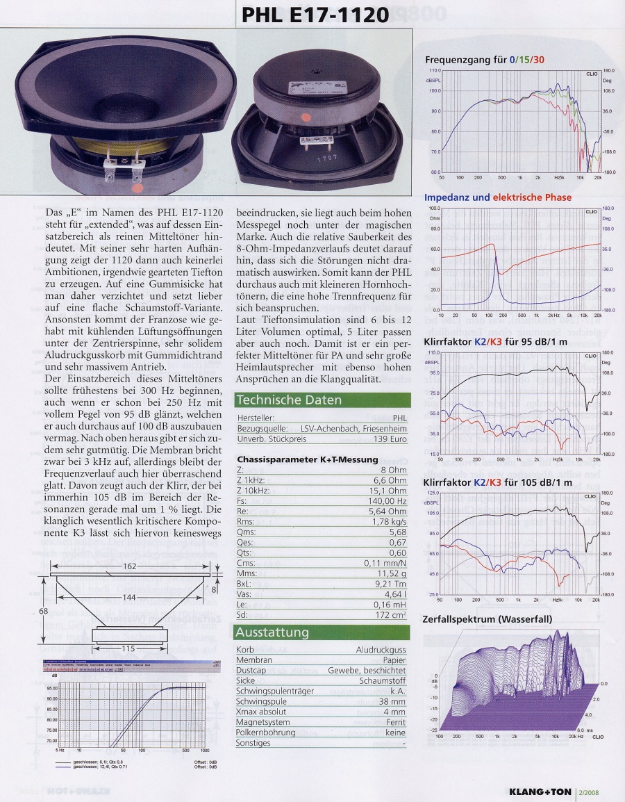

Little update on PHL drivers.
While i could not find FR of all current models, it appears that the midbass ones have depressed LF reproduction, which is not acceptable for me.
Instead the extended midrange 6,5" such as 1120/1130 is pretty smooth (see attached test results) and most importantly has been used cut at 250hz with only 1st order, although the upper range will require more shelving.
Two 1130 in parallel I think that could be cut at 200hz whithout sacrifying SPL too much, which is ideal for me.
Moreover they are much cheaper than the Supravox 165gmf (140 vs 240€).
This road seems more satisfying than the single 8" because will allow me to try a MTM configuration and reduce beaming.
