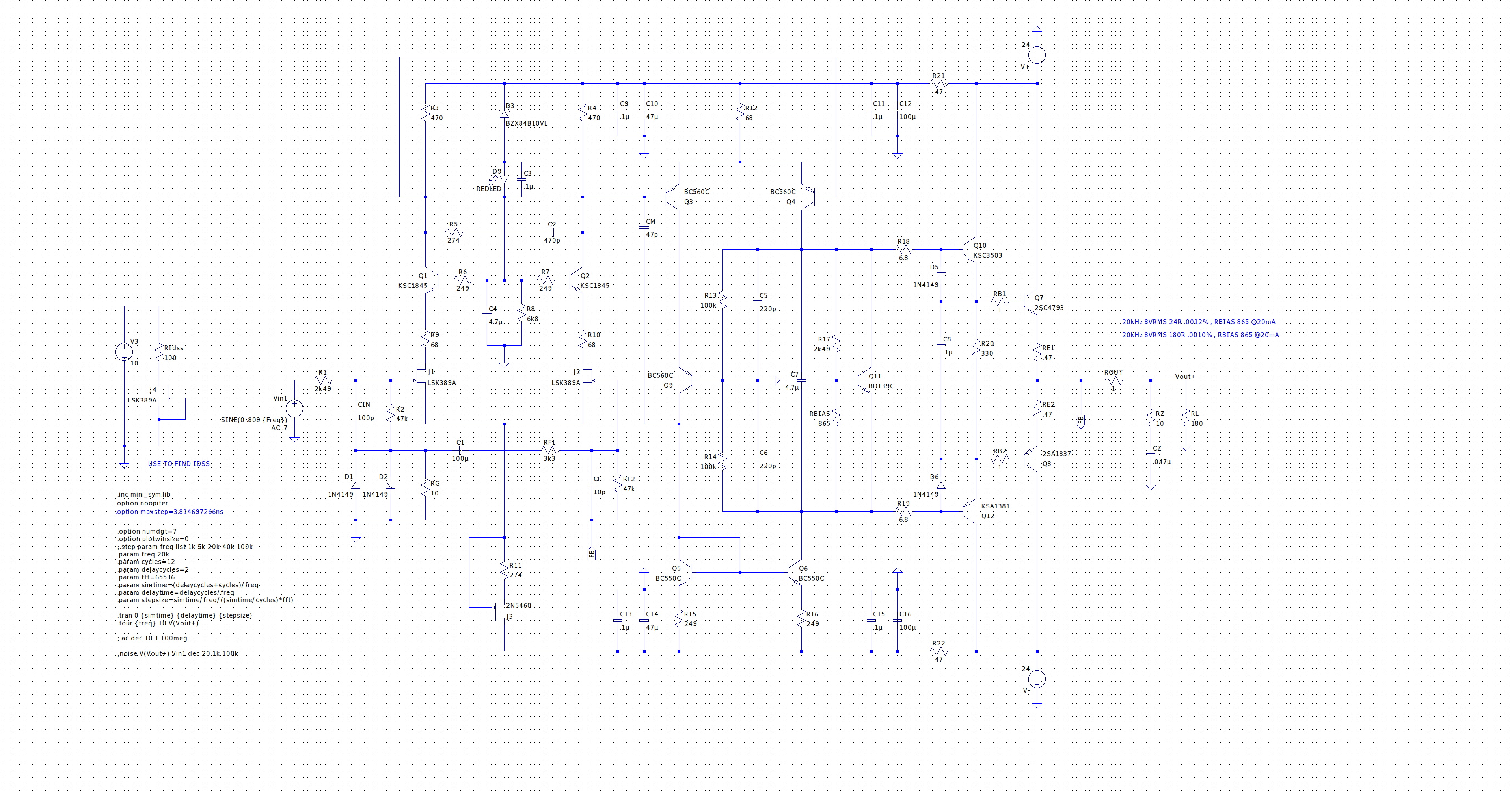

symasym headphone amp idea
Spent too much time doing simulation/modeling for the past month of summer break before summer school started and came up with this. It's pretty much the symasym with JFET input and VAS/Driver output stage. Models nice. Not sure if I'll build one I'm trying to do something simpler and get good results as well. Tried messaging the guys responsible for the design of the symasym so I hope this is not out of line.
The sim gives .0012% THD @8VRMS 20mA Bias 24R load. Bonus all parts are readily available.

Hi Beycoast,
You would use a THD meter to find the happy spot for the bias current, then bias a touch higher. For stability you need a scope and square wave generator and adjust the feedback cap for no ringing. You could make it a little higher if you wanted, just for a little extra safety factor, but not much.
Unless someone actually built this using your choices of transistors, it is impossible to tell you what the values should be. A simulator will not get it right because there are a lot of other factors that are not modeled. Just build it and measure.
-Chris
