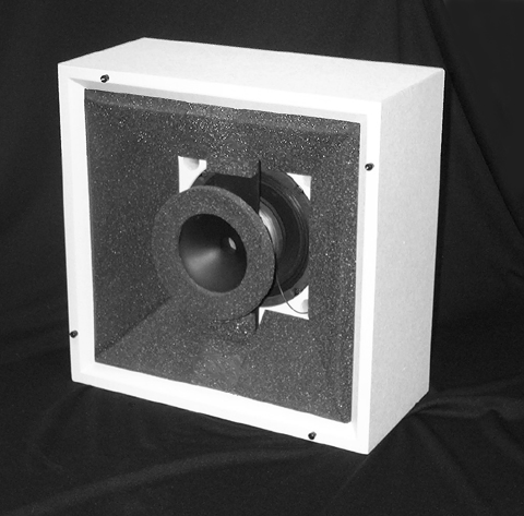

If you didn't get a big timbre shift, recommend very near field absorption around midrange horn mouth (about 1/2 to 1 metre distance radially), across top of top hat, on floor in front of Khorn (about 1-2 metres). Should be big improvement in center phantom image performance.
