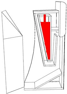

After reading the entire link, it sounds like chambers are the best way to create band-pass filters, but the example graphs show the filters as very efficient in cutting out a band...i wonder if it would do more harm than good trying to tame say 220Hz with a chamber.
Other questions I have after reading...
Does the chamber have to be branched off the throat of our horn system or could it be branched from the compression chamber and have the same effect?
To begin calculations, you need "a neck with radius a". How would I start with a square neck, say 12mm x 12mm.
Or maybe I don't need a square neck, perhaps just drilling a hole to the center chamber in the frugel horn would be enough. Give the right size hole, and filling the chamber to the right volume might work, maybe???
So, even doing something like the following, assuming the diameter and length of the tube and the volume of the new chamber were derrived from the equations in the link above... it wouldn't work as expected in a horn?

GM said:
AFAIK it would have to be tapped into the throat.
GM
I've thought about it a bit and I'm not sure how I can do that without cutting off the top of the box. If the opening of the helmholtz port is placed right near the throat opening (directly undernearth the throat opening at the top front of the filter chamber) is that maybe close enough? That would be about as close as I can get without major surgery.
I'll be working on this soon, and I'm hoping to eliminate things that won't work since it's such a tight spot to work in. If I have to cut the top of the box off I might end up doing that but I'd like to avoid it if possible.
Dunno. I mean to get the best vent measurement accuracy requires the mic be placed inside it a bit, so it seems reasonable to me that porting the trap near the throat may not (won't?) yield good results since to some extent it will be converting the filter chamber to a double bass reflex (DBR) one, at least to my way of thinking. Maybe you could use MJK's DBR WS to get an idea. I'm not hopeful though.
