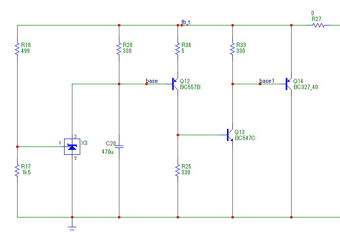

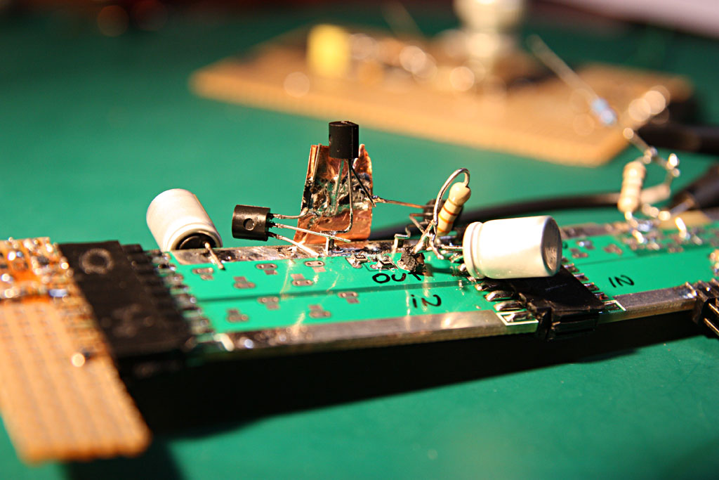

So, I stuck a huge booster on the poor thing. See schematic.
The triple-CFP controls the output at high frequencies. It is extremely fast. It looks a bit like a Salas Simple Shunt.
The TL431 controls the triple-CFP, and brings voltage precision, temperature stability, etc.
It is a nested feedback system. The dominant pole of the inner feedback loop (CFP) is created by the output cap, which needs to be low-ESR, low-ESL, and more than about 100µF. No problem with that, I'm designing this regulator to suit the caps I'll use...
The outer feedback loop goes through the TL431. C20, which needs to be around 200-400 µF, filters out the TL431 high frequency noise, and provides the dominant pole.
There are no capacitors which would need to be X7R (ie, annoying values like 100nF or 1µF) anywhere near the feedback loop. Accordingly, when tapping the board with a pencil, it does not produce a HUGE voltage spike like the LT1761 does... (I used a 10nF X7R for the noise bypass cap)...
Of course, I built it following the Tradition of Ugly.

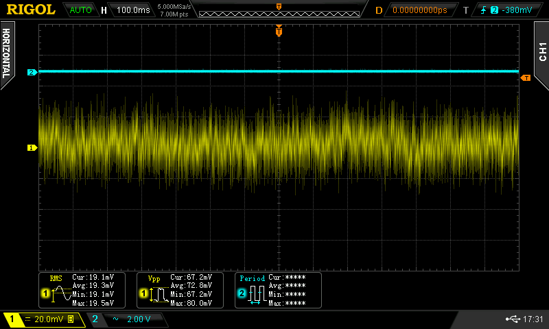

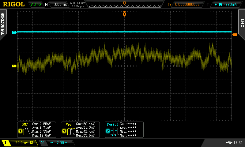

So what is the performance of this ugly bastard ?
First, Noise : about 20µV RMS in the same bandwidth as the previous measurements.
So, thanks to the filtering and the lower current going through the TL431, it actually has less noise with the booster than without... Much of the high-frequency noise has been removed.

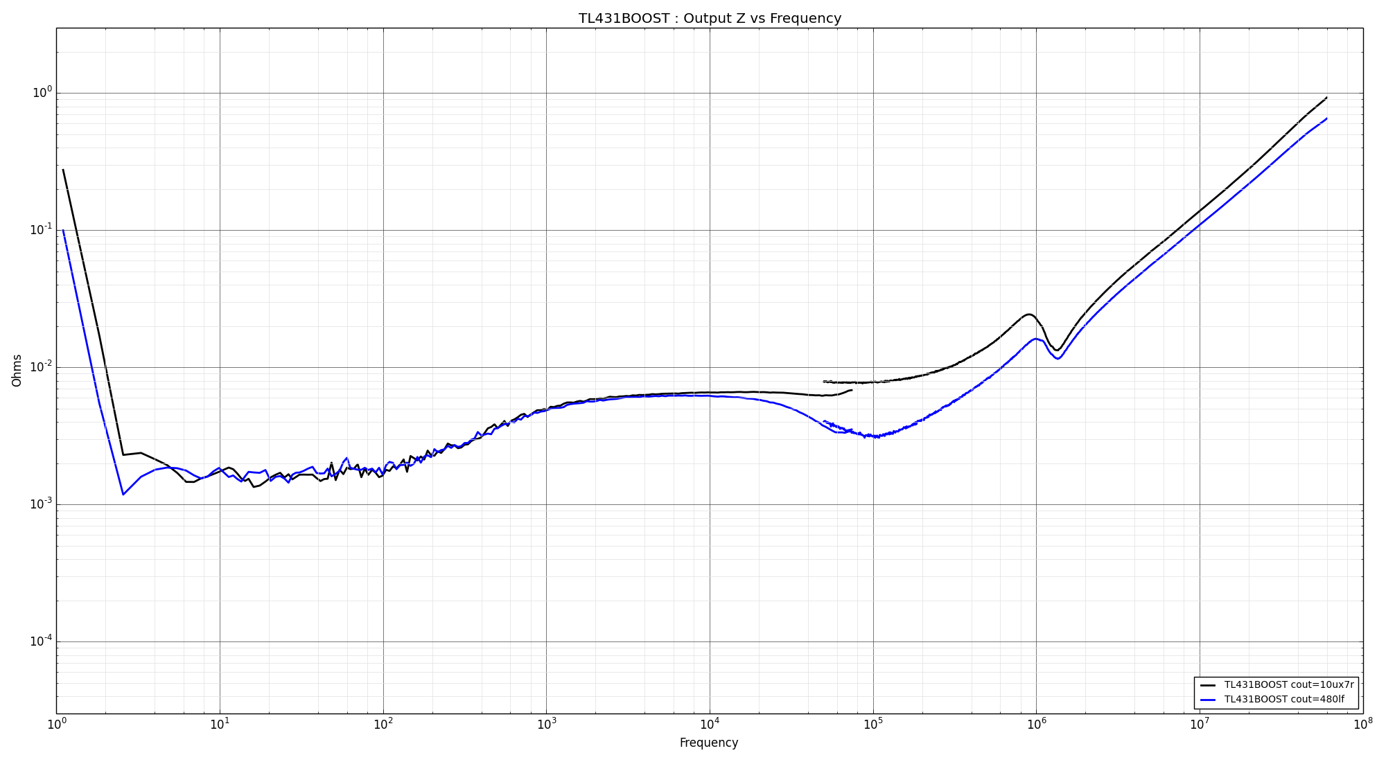

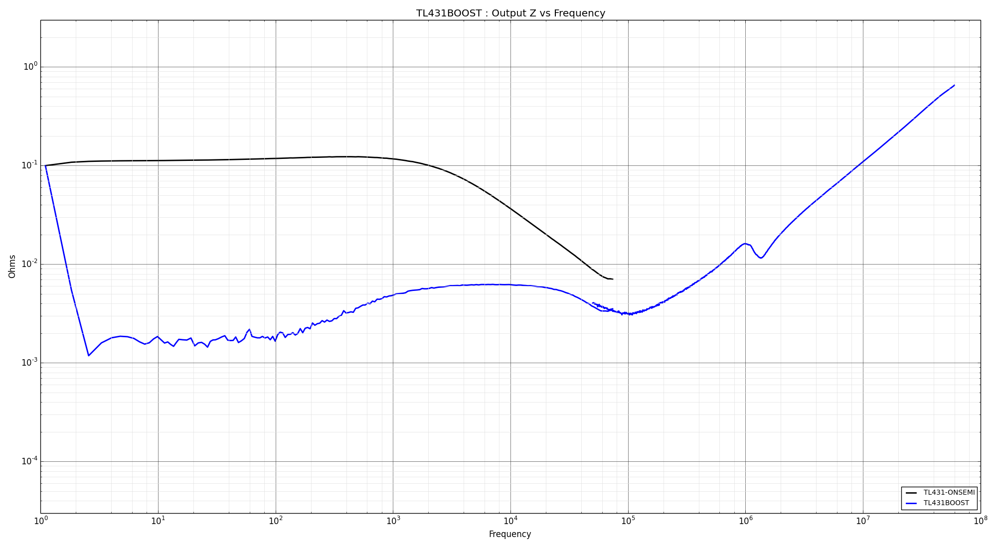

Now, output impedance...
Black is "raw" TL431, blue is with booster.
Pretty low impedance, identical to simulation results. In the noise floor at DC, and something like 5 mOhm above. Smooth transition to polymer capacitor...

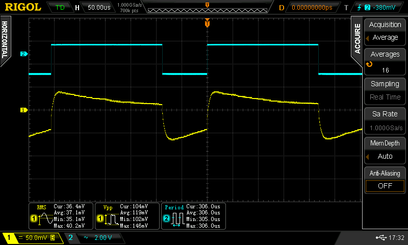

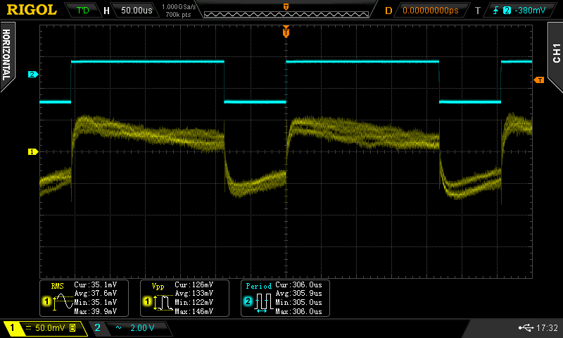

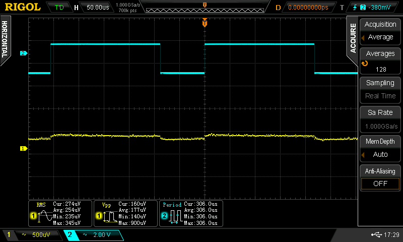

Transient response, same as before. The shunt current is stepped between 23mA and 40mA, a 17mA step. The blue trace shows the load steps.
First scope shot : There is a problem here... The 500µV/div setting on the scope barely shows anything useful... I had to use averaging, which screws up the RMS values on display. The peak to peak measurement seems to agree with the measured impedance, though.
Next 2 scope shots : using x100 preamp confirms the amplitude of voltage variations.
It appears that the output at fb_t equals the TL431 voltage, plus Vbe_Q12 + (Ie12 x R36).
Yep, the TL431 output voltage. You forgot the feedback loop...

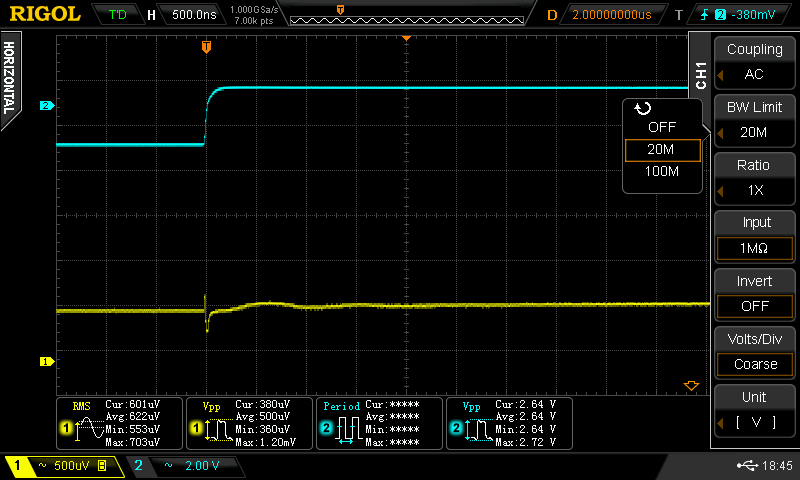

Attached is a scope trace at 500ns/div to show the transient. Nothing to see really. The little undulations after the load step are present also when the regulator is off, so they probably come from the step generator...
Not bad for about $2 in parts...

So, I ran a test without the 470u polymer cap at the output, just the 10u X7R 1206 cap. You were right, the 470u is unnecessary. With just the ceramic cap, it works almost as well. No significant change in transient response... Output impedance measurement attached.
I will breadboard a prototype with SMD transistors on a proper low-inductance fixture (this test fixture has rather high inductance, perhaps a few nH). I want to be sure it doesn't oscillate !...
Actually the regulator (as measured) seems to have around 5nH output inductance, test fixture included, which is really very low for an active regulator.
1cm of wire is 5-10 nH depending on the wire diameter, but that's not very interesting since this is a local regulator so it will be on the PCB and close to the chip.
1cm of trace is about 2nH (4 layer, 1mm wide, 0.2mm over ground plane).
