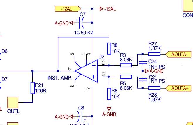

For those of you who wants to use only one op amp (LM4562)
Here is a schem which doesn't roll off the highs and is direct coupled to the dac. There's no cap at the output and no output dc.
This is the best I used with an op amp on this dac

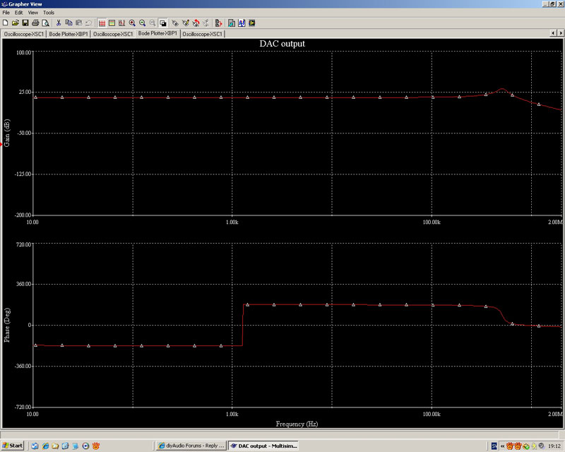

Hi legarem, you wrote in post #101:
I have simulated your proposal and agree that it doesn't roll off any highs, in fact it doesn't work as a filter at all. If anything, omitting C32/C33 makes it prone to oscillate at around 0,5 Mhz.
I still put my money to the filter designed by Crystal and discussed in a few of the previous posts by me and Kevin, it does exactly what it is supposed to.
1.87K with 1n cap gives 85.1 khz at -3 db
Oscillating op amps is often due to poor power supply layout
0.01 to 0.1 caps placed between V+ and gnd and V- and gnd
NEAR the op amp often cure this problem

This discussion is a no-win situation for everyone involved, since it is about believes and opinions. Subjective listening tests, and to make it worse done in intervals of hundreds of hours doesn't account for anything else than just opinons. It might even be changes in the barometric pressure that's affecting one's hearing or speaker response as far as I'm concerned. To do a comparison that's worth the effort you have to listen to both "new" and "burned in" at the same time and do ABX switching. So I'll bugger the ****out from that discussion after this reply.angel:
Thanks legarem for you reply on DIR9001. It sounds (!) like it's worth a try.
I actually am a "practician" and spend more time with my soldering iron than doing computer simulations. However, simulations are extremely helpful when "trying" different ideas so you know if you are going in the right direction or not. The first solution offered on Lampizator is, what I would say, - not.
As for your filter design, you have to consider the whole circiut and not only the 1k87/1nF. The frequency response of the WHOLE circuit is attached below. Note the phaseshift in the mid range. THAT is more than likely to be audible.: ;)
