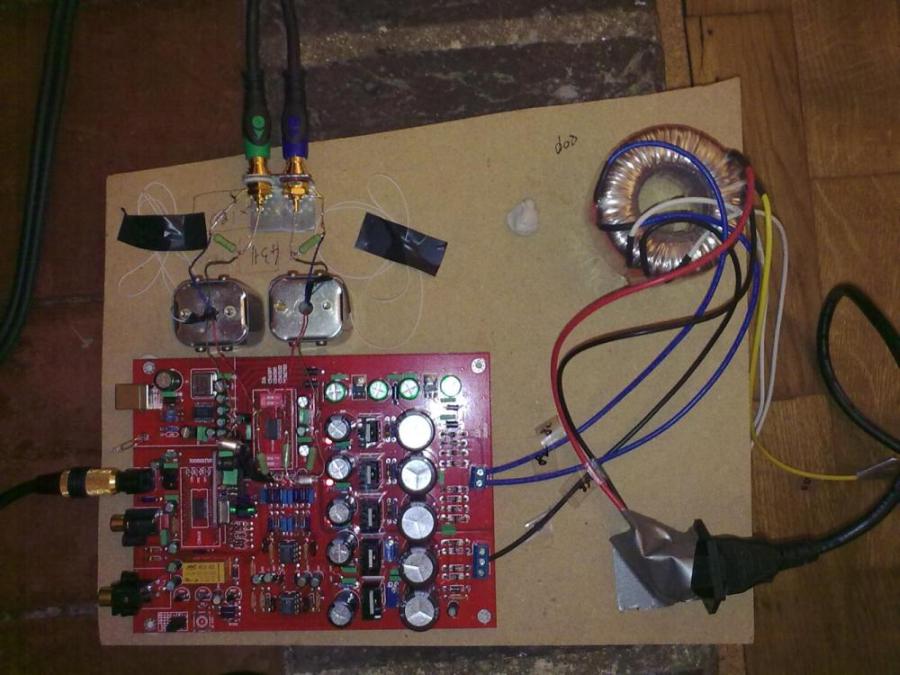

That's nothing, check mine out ;)!
Okay, so it ain't much of a looker, but IT LIVES!!! Sorry, but I couldn't resist exposing this ugly duckling, I am so delighted with it!
Thank you everybody for this thread, especially those who answered my newbie questions (legarem, Franz Gysi, Kevin Wood).
It sounds good already, even with long, dodgy interconnects. Now then, where did I put that spool of Kynar wire..! (DIY interconnects!)

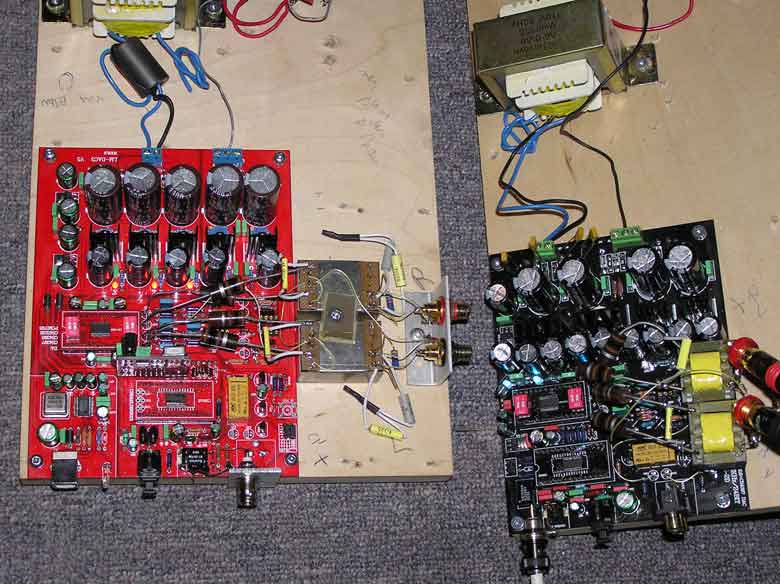

Here are my ugly dacs
There's one with lundahls and the other one has Studer uncapsulated transformers I bought from Franz. The first time I tried them, the sound was so bad so I decided to forget them.
Last night, I was thinking that Studer can't do something so bad so I decided to try them again but with a 600 ohms load like the Tams.
Humm ... It is now a real different story
Franz
If you still have a pair try them and give us your impression.

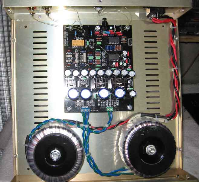

Somday I'll make mine like the ones I do to other peoples who want clean jobs.
Prototyping is funny. Doing cosmetics is a nightmare. I hate that !
Here is one I made a year ago when Lukasz Fikus published my LM4562 op amp mod. There is two monstruous transformers.
Later, many peoiples asked me to replace their toroids with EI transformers when they heard the difference

Try a EI standard transformer (big 9 volts 2A) to replace the toroidal and give me some news. You'll be surprized by the results.
I am surprized about your findings. Could it be, you have dirty mains?
Do you filter the mains before the trannie?
Yes, I have some. As soon as possible (too many projects and now the LL1690 are built in the box) I will try them again.
