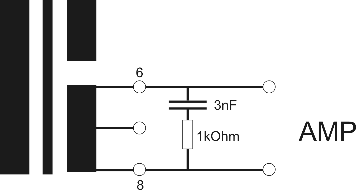

Experience with this DIY DAC ?
Has anyone questioned this DAC's output (reconstruction) filter?
It's quite different from Cirrus CS4398 datasheets and the values look weird for a 2-pole differential filter :confused: One leg is 45kHz and the other looks like 7.34kHz, which means a 1nF cap should be an 82pF cap...?

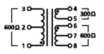

I'm using this transformer:
http://www.google.hr/url?sa=t&source=web&cd=3&ved=0CB8QFjAC&url=http%3A%2F%2Fwww.monacor.dk%2Fprodukter%2Fproflyd-linedriver%2Fvnr%2F210500%2F%3Ftype%3D257%26no_cache%3D1&rct=j&q=Monacor%20LTR-110&ei=aCiJTYavO87esgb2__S9DA&usg=AFQjCNHbZbxw-6v9I87KDrlf1S7TTyDUZw&cad=rja
thx
Maybe I should clarify, this is schematic of the Monacor LTR-110 audio line transformer...output lines are conected to pins 8 and 6...I hear buzz when DAC is connected and turned on, it is posible to hear it when no musical signal is being played, with volume turned up halfway on (2x50W) amplifier. If music is playing, buzz cannot be detected since it's allways significantly quieter than the music signal.

This is what promo material has to say:
"Audio transformer 1:1/2:1 for line signals
Unshielded version with print connections
• Wideband version
• Change from unbalanced to balanced and vice versa
Galvanic isolation to avoid/eliminate hum loops
• Various level adjustment possibilities when windings are arranged accordingly
When installing unshielded transformers into units with interference fields (e.g. power transformers), attention
has to be paid to respective shielding measures
Technical data:
Frequency range : 15-30,000Hz
Transformation ratio : 1:1/2:1
Input impedance : 600 Ohm
Output impedance : 600 Ohm/300 Ohm
Optimum source imped. : 50-600 Ohm
Optimum load imped. : ≥ 5k Ohm
Max. input voltage (1%
THD/40Hz)
: 5V
Dimensions : 25x19x19.5mm
Weight : 28g"

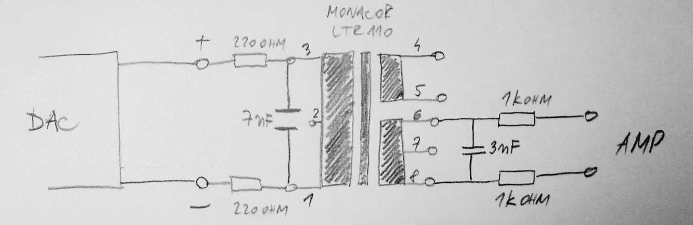

Trafos are connected as per Legarem/Gerarda advice...
input side...please ignore the output side, it's wrong...
http://www.diyaudio.com/forums/atta...82d1254231813-experience-diy-dac-dsc00926.jpg
output side...
http://www.diyaudio.com/forums/atta...2458d1254309555-experience-diy-dac-filter.jpg
Have you tried moving them? There's nothing wrong with your wiring. You can also move your power trafo.
I'll try,...thought of that, but unfortunatelly, I allready glued them to the board, so I'll have to be extra carefull, they are tiny...
They are allready as far from power trafo as board would allow (cca 15cm)...
BTW, how should one go about shielding them?
What I did not understand in few previous posts about grounding the output (audio) trafos is which leg I should ground? Edit: in post #3715...
And one more question: power trafo was taken from old CD player - I remember that at some point there was connection to the metal chassis, but I think it was from the internal PCB, not the trafo. Anyway, trafo has original two prong connector without grounding...and I don't know if maybe I should ground trafo chassis or something...I know, this is really not my forte, I should do some serious Electronics basics learning...
If you're going to ground an output leg, ground the one that's connected to the RCA shell, naturally.
The chassis should ideally be connected directly to the house ground for safety, and a bit of shielding. You could use a steel partition to help shield the OP trafos from the power trafo if that is where the problem is.
Well, it turns out it was power transformer problem. I was confused because when I assembled dac/trafo for the first time I did try different orientations but since I did not turn the volume all the way, i did not hear the buzz...it's only after the halfway that it becomes audible...so now I maxed out the pot, rotated power trafo around two different axis and also moved it a bit farther from the monacors...all is well and allmost completely silent at max pot position...
thx again, Bill

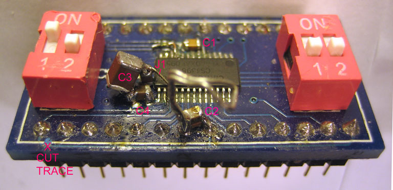

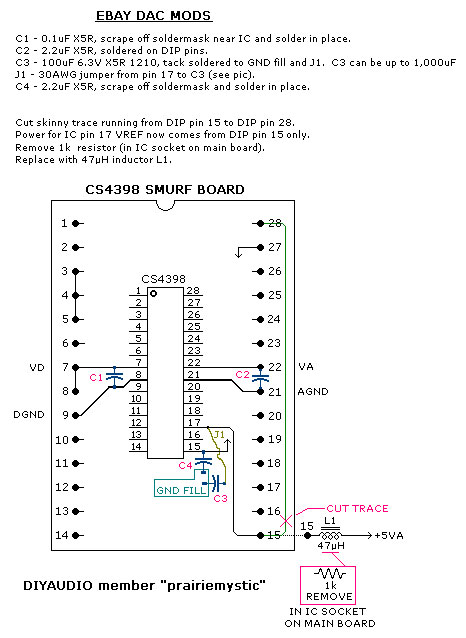

My mods to the CS4398 smurf board
Here's the schematic+pic of basic first mods I've done to the DAC. They are high risk to wrecking your CS4398 daughter board, due to the low pcb quality... and wouldn't win any beauty contest, lol.
It's mainly adding SMT ceramic decoupling caps close to the IC pins. I found these have huge improvements to the DAC's sound; I also used a 'scope to verify noise and ripple.
I haven't optimized the caps; C3 (on VREF) needs to be low ESR and easily 820-1,000uF before the VREF signal gets clean DC. Cirrus used 1,000uF to keep their distortion curves flat on the low end (<100Hz). This VREF pin is really demanding and sound quality changes a lot with cap type and lead lengths. I think next would be to drive the pin with an op-amp buffer.
I got ticked off at the traces lifting so I laid out my own version (smurf) pcb with proper ground fill and thick traces, but they're not in yet.

why do you ground C4 & C3 to other grounding? Aren't it be easier to ground the caps to pin 16 (REF_GND) ground ref....
C4 rating is 6.3V for SMD, where else max V for 4398 is 5V, is it safe to do this???? What's the different if I choose radial type of X5R which has bigger V rating....or maybe a film type....???
For inductors, C1 & C2 mod is this worth while to do if you already have a linear psu for the dac?
